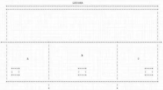

So where does all this weight go? Diagram shows a top-view of the deck, divided into sections. One half towards the ledger, the other half further divided into regions around the posts. These areas estimate how the weight will be distributed.
Assume half the weight of the deck is taken by the house ledger, leaving 3250 lbs for the posts (actually if the deck overhangs the posts they would take a bit more).
The 3 posts won't split the weight evenly: area B = A + C, therefore post B will take the most weight. Assuming A = C then we have A + B + C = A + (A + C) + C = 4A = 3250. So A = C = 812.5 and B takes about 1625 lbs.
A 10" post has an area of π r2 = 3.14 * 5 * 5 = 78.5 sq inches = about 0.55 square feet.
(If the post were 12", then you'd have 113 sq inches = 0.8 sq ft)
Dividing the weight per post by the post's area, you get:
1625 lbs / 0.55 sq ft = 2955 lbs/sqft for post B.
(Using 12" posts, B would have taken 2030 lbs/sqft).

If you do need to make changes, one option is adding one or more additional posts in between A-B and B-C. This would spread out the load.
