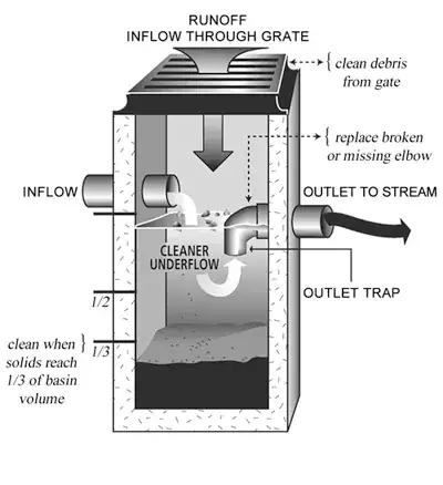

One mitigation you could consider is one or more sump pits/traps/catch basins along the path. Here's a sketch from Dejana Industries:
catch basin diagram
This construction is specifically designed to catch debris in storm water systems. That's not what you're after, so we can modify the design a bit.
Run pipe with a continuous slope at a sufficiently steep grade so that debris will carry along well. When you reach a point that the pipe is getting too deep in the ground, install a catch basin there. Take an exit pipe out of the pit at a level higher than the inlet and proceed to the destination.
During a storm water will fill the catch basin. Eventually the water level will rise high enough to flow out the exit pipe. Some debris will settle in the basin; other debris will float up and flow out the exit.
Construct the basin to be leaky so that after the storm the water remaining in the basin slowly drains away. That'll minimize the chance of breeding mosquitos or odors. From time to time you'll have to clean out the debris from the bottom of the basin, but it's better to have it there than in some unknown and inaccessible section of pipe buried in the yard!

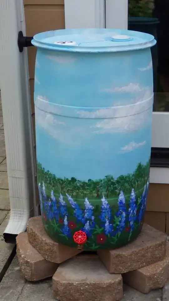

One idea is to elevate the 50-gallon container in the backyard that is initially catching the water. Instead of setting the 50-gallon container on the ground, you can use pavers or other sturdy materials to create a platform on which the container will rest. Elevating the container itself will elevate the container's drain hole, which may give you enough elevation so that the piping to the front yard will run downhill.
Note: 50 gallons of water weighs 400 pounds, so whatever you set the container on needs to be really sturdy.
My rain barrel is only 35 gallons, but you can see that I have elevated it about 10-12 inches:
rain barrel painted with bluebonnets
