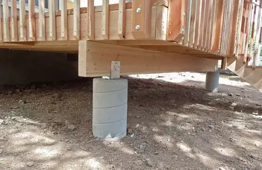

If you don't like posts in concrete (in my area there's enough water that these are problematic) I'd recommend looking at piers to replace the posts. These are concrete cylinders that the entire deck framing rests upon.
