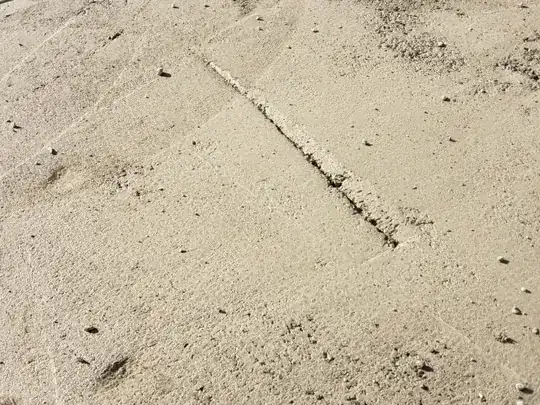

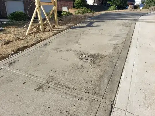

Yesterday we had new concrete pads poured. We expected pour-day to be the last day. I saw them out there finishing, but when we went out that evening after everyone had left, it looked half done. There were unfinished areas, dips in the concrete, and piles of stuff:
I texted the concrete guys and asked if they were coming back after dinner or what was going on. They texted back that it's normal for it to look like that and that they were coming back today with a grinder to finish it out.
I've never heard of using a grinder as a finishing step (though I've only been a part of a few driveway pours). Is this normal? Will there be any long-term consequences (to stability or performance or appearance) of using a grinder at the end like this instead of just finishing it when wet? Or is this a red flag that things are about to go very badly and I need another contractor to come in and tell me the correct next steps?
I worry that the guys weren't prepared and just ran out of working-time.

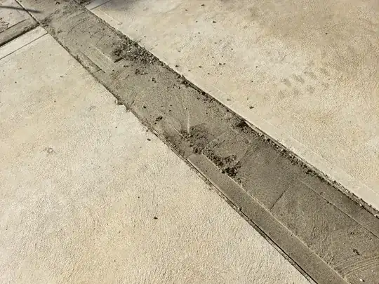

The resurfacing product manufacturer told me their product would only last 5-7 years. I talked to another, experienced, concrete contractor who recommend a complete repour, and I hired them to do so.

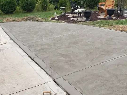

The repour came out absolutely beautiful (photos below; please ignore the skull, it was Halloween), though they could not get all of the concrete splatter left by the original contractor off the old driveway. I've filed a lawsuit against the original contractor who has since stopped communicating with me.

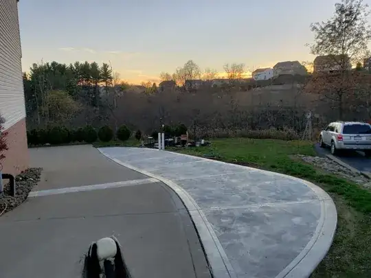

New driveway New driveway after cure

That looks like a very poor finishing job to me. I've assisted on many driveways and never had to go back with a grinder. Finishing it wet is all it takes and leaves the desired surface that isn't slippery. Watch them carefully and hold off on final payment until you're satisfied with the job.

Jack has a good answer but want to add. This strikes me as a concrete job done after they did another with whatever was left over. If the mix is that dry there could be major long-term issues.
From your picture (and I know its a picture and I am not there) it looks like that mix was never wet enough. You simply don't get "crumbles" with poured concrete. They tried to flatten/skim the concrete either way too late (I doubt) or with mix that had started to settle.
The "crumbles" left potmarks. These are a disaster if you are in a wet/cold climate. Water will sit in them, water will freeze, and the normal concrete issues you get at year 10-20 will happen in year 5-6.
And to answer your question - no you don't use a grinder on a concrete job. Also a grinder would be used to shave things. While the "crumbles" need to be shaved if they stick, the bigger issue as mentioned before are the small holes (potmarks) left. How does a grinder fix that?
