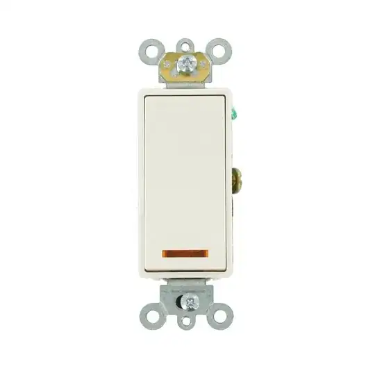

Back to the original problem. There are lighted switches available such as: enter image description here
However, as with smart switches, dimmers, timers, motion detectors, etc., lighted switches have to get their power from somewhere. There are 3 options:
  • Neutral - Arguably the best, but neutral is often not available in switch boxes in older homes
  • Ground - Usable in limited circumstances. Do not use ground instead of neutral unless the device is designed to do so.
  • Leak current through the main circuit - Lighted switches used to all work this way. Many still do. The problem is that this is generally not compatible with LED lighting.
If you decide to install lighted switches, make sure they are compatible with your wiring and with your current and anticipated lighting fixtures.
