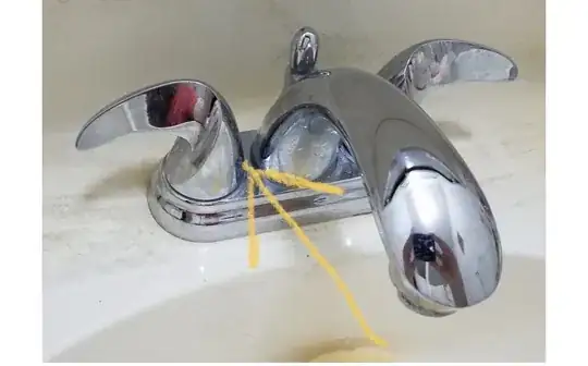

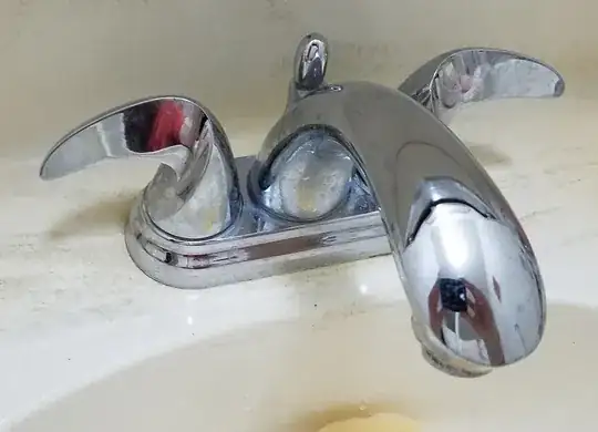

I'm trying to remove these bathroom faucet handles. There are no screws anywhere on the outside surface.
Is it just a matter of prying them off, either using a screwdriver or just pulling up on the knobs really hard? Or should I try turning the knobs the wrong way?
I don't want to force it, so I figured I'd ask first.
Does anyone recognize the make / model? It would be good to know what replacement parts I'd need to buy before I disassemble it.

If there are no obvious means of disconnecting, it ALMOST has to be a "pop off" design. What other options are there??? I'd take a putty knife and gently pry on it from different sides and see if it "wants" to break free.

enter image description here enter image description here I think I see the set screw at the base if the handle.
Usually a small Allen wrench.
