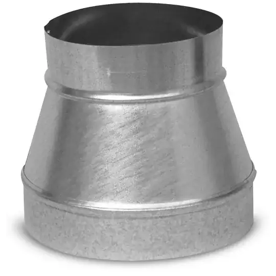

Yes it will work. There are many different types of 4" to 3" reducers that will work with your fan. You will have to match one to the material of your vent and the duct. Below is a picture of one sold by Lowes.
