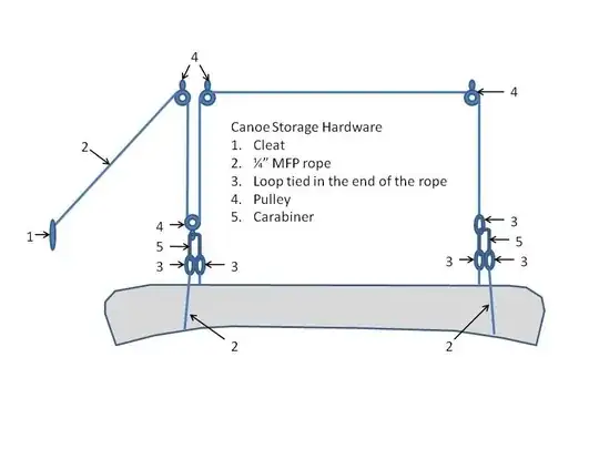

I am building a kayak hoisting system for my garage, and was originally going to use a standard two-rope system to keep the kayak level when hoisting, but I came across this single rope schematic, and was curious if it would actually lift the kayak level or not. My spidey sense says "no", but wanted to confirm: enter image description here

No, it will not, at least if the load is balanced as shown. The leftmost part of the kayak / canoe, having a snatch block on it, will experience twice the lifting force as the front of the kayak. If the kayak was moved towards the left, it could potentially balance out, but you will likely need to do some manual adjustment as the kayak is lifted.
IronEagle
  • 1,451
Wont work, the left side of the canoe will rise in preference to the right side. Even if the right side is heavier, mismatches will tend to arise.

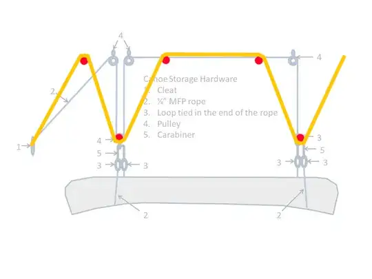

Solution:
Keep both the ceiling pulleys, and add an extra pulley to the ceiling pulley on the left. Use two ropes (one short, one long) that go from the canoe.
When the canoe is in the lowered position, connect the two ropes at the left of the "double pulley" so the short rope ends there. If done thoughtfully this will stop the canoe lowering further so it can be unloaded one end at a time.
The remaining long rope goes to the wall attachment - one rope solution.
Perhaps someone could provide a diagram? enter image description here

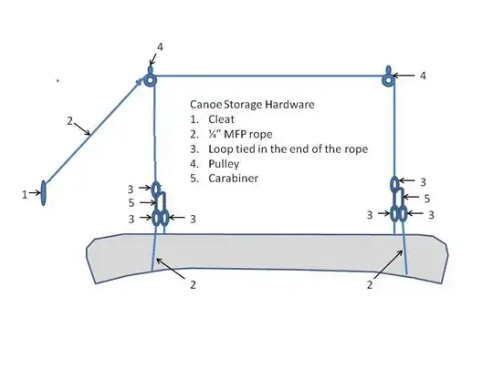

Here is a single rope arrangement that solves those problems:
Balanced single rope arrangement
Doubling the rope along the right side pulley makes the force equal.
Spreading out the ceiling attachment points provides negative feedback: if one side is higher, the angle of the ropes on that side is shallower and the lifting force is smaller. Thus the high side will rise more slowly, regaining horizontal orientation. It is important that the spacing of ceiling attachment points is equal on both sides.
The spacing is a trade-off: wider spacing gives more stability, but it also increases the force required to pull the canoe up.
