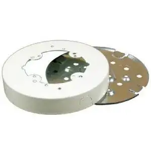

As discussed in other answers, it is not so hard to install switches and fixture boxes in walls and ceilings.
If you are determined not to do so, you can use surface wiring. This consists of a box that sits over an existing outlet box and then leads the power to other switches and fixtures.
surface box
Wire runs from this in a metal surface channel
wire channel
It can connect to a surface mounted fixure box
surface fixture box
You also can connect a switch in the line. There are also corner pieces that let you bring the wire to another wall or to the ceiling.
