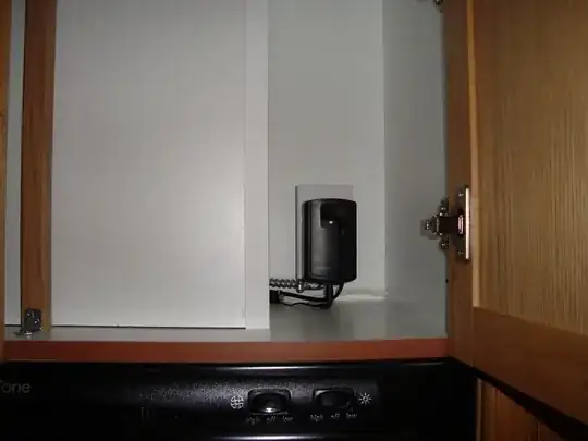

I'm trying to run power for some under-cabinet LED strip lighting. I think the easiest way is to tap into the stove hood, so my question is: how do I do this in a way that is legal and meets code (preferably without tearing apart cabinets/walls)?
Here's the cabinet:
inside cabinet

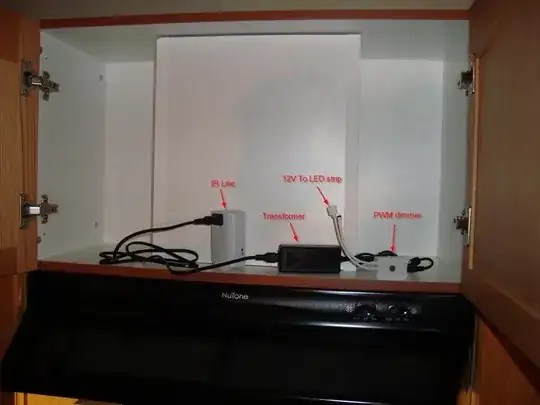

I need to plug in an IRLinc (3-prong plug), the transformer, and the PWM dimmer controller. I'll also have low-voltage 12V wire exiting out both left and right sides into the adjacent cabinets.

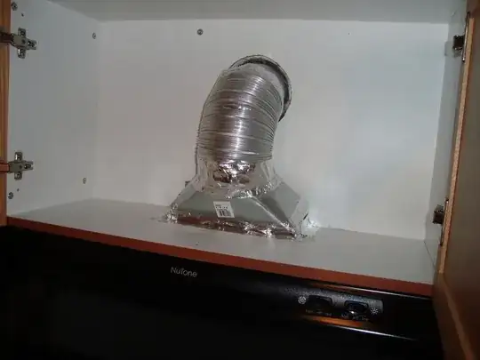

The white box in the center is just some MDF that is covering the vent pipe:
vent cover removed

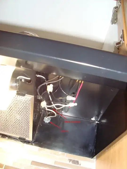

The power for the hood comes in from the wall:
wiring inside vent hood
Can I run a piece of BX or conduit up to a surface mount box secured to the back of the cabinet? Is it legal to use the vent hood as a junction box (note there's normally a metal cover over those wires)? Any better suggestions?

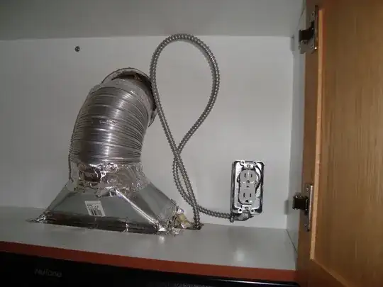

UPDATE:

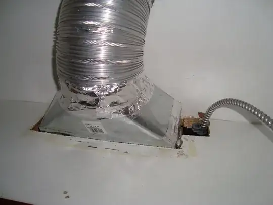

BX worked fine. I cut out a big hole because I needed room to be able to put the hood in place with the BX connected, and I left a big loop so there is room to pull the hood down a bit before disconnecting the wire.
hole in cabinet outlet connected finished cabinet

I'd use the range hood box as a junction box. It meets the code definition of accessible:
Capable of being removed or exposed without damaging the building structure or finish or not permanently closed in by the structure or finish of the building.
And in most places should pass just fine. I'd use BX because that MDF hood cover is rather easily removable, and treat the wiring to the new outlet as 'exposed'.
