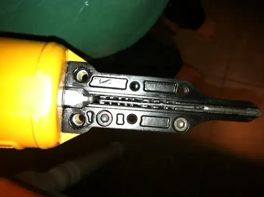

I then disconnected the gun from the air supply line and took the nozzle off. This is what I found:
Every now and again I get a misfire when it tries to fire two nails at the same time. In these situations, I disassemble the nozzle like I did here and get the nails out. When I took the nozzle apart this time, I noticed that the "hammer" (the thing metal piece that drives the nails in) was not in its correct position.
Usually, the hammer is fully extended, taking up the entire length of the nozzle that you see above. However, in the photo, you see that the hammer is stuck in the "ready to fire" position and will not come out.
I'm not sure if that's the problem (that the hammer is stuck inside the gun), or if something else is going on, but I've spent almost an hour looking at this and am at wit's end.
Any gear gurus out there see what the problem is? Is there a set of things I should be looking for to render a diagnosis?

Oiling your gun on regular intervals is important. In your case, if the pin is stuck, try the following.
Put several drops of oil directly on the pin and slide channel. Remove all nails, reassemble the nose and see if the gun will dry fire against a scrap piece of wood. the gun should fire and leave a dent from the push rod in your wood if it is working.
If the gun still does not fire, then the pin may be damaged or bent. At this point the upper air chamber will have to be removed and the pin assembly removed/replaced. Rebuilding air guns is not real difficult and parts for a Bostich are readily available. You problem may be a worn or damaged O-ring in the compressor section. Rebuild kits for the upper end have got to be replaced often, especially if they have not been oiled regularly of after long periods of storage. Parts are cheap.

Seems like the allen wrench fittings up top are special sizes, as my Dewalt tool did not have the right measurement to get a tight grip on the heads. I ended up cranking the compressor to about 120 PSI, depressing the head, then ejecting the stuck brad out by pure force of more air. Worked great!

This happened to me. The nails got stuck, and it didn't sound right, so I pulled the safety cover and the driver guide cover. I removed a jammed nail twice. I finally decided to try a sleeve of nails from another package, and it all worked.

Make sure the nails are the proper gauge for the gun. I mistakenly loaded 18 ga nails into a 16 ga gun. It did the same thing you described by trying to shoot two nails at once. When the 16's were loaded, it worked flawlessly.
