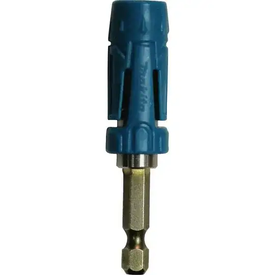

Those little bits aren't really made to go straight into the chuck. Even if the chuck is made to grip the little grooves, it's hard to see the tip with it so close to the chuck. There might not be enough room to get the whole nose of the driver in that close to the screw. Those bits
bit
are best put into a bitholder - the bitholder will grip the little grooves so it doesn't fall out, and it gets it away from the chuck a bit.
bitholder

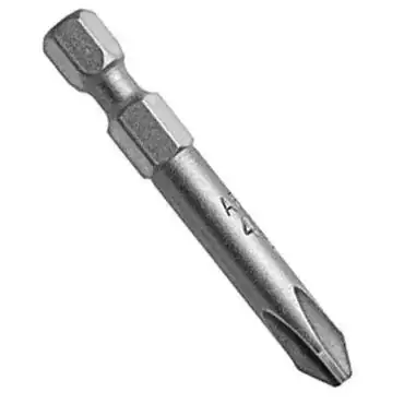

You can also buy screwdriver bits that are made for the chuck, and these bits will be long enough that they are easy to use placed directly in the chuck. You can see it has the same style shank as the bitholder.
screwdriver bit
There are about four million of these in HD, L's, etc.

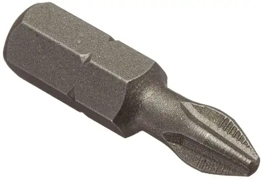

  • The short bits with at most a small notch on the shank are known as "insert bits".
  • The long bits with a wide groove on the shank are known as "power bits".
When you have a tool that takes power bits, you use an adapter for insert bits. Many adapters of this type have no moving parts and use a magnet to retain the insert bit, so they look like a plain cylinder with a power bit shank sticking out one end and a hex hole on the other end.

Get a bit tip holder like this one
