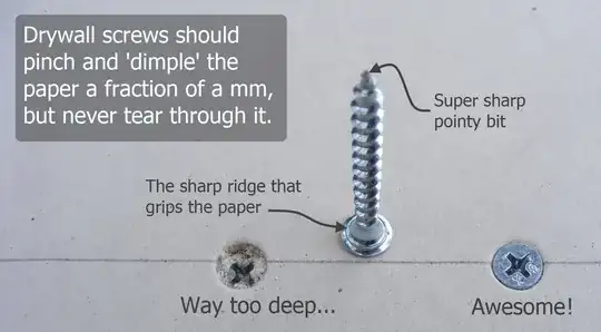

Old thread I know,but it still shows up in results, so I thought this image might prove useful to anyone new to drywall... how to: drywall screws
