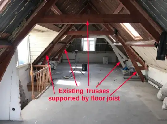

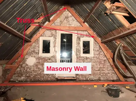

Currently, the masonry facade on the top floor of a four-story apartment in Rotterdam supports the apartment’s roof. This masonry facade will be removed and its role in supporting the apartment’s roof will be replaced with a wooden truss that has already been constructed (as seen in the image below).
Truss and wall to be removed

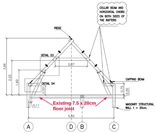

The truss elements are all 16.5 x 6.5cm douglas fir, the truss is resting on a 7.5cm x 20cm wooden floor joist from the original construction. Both ends of the wooden floor joist are embedded into the masonry wall and the floor joist is supported by a 12cm x 7cm wooden fill beam at gridline B in the section cut below, this fill beam has adequate capacity in moment and shear for the additional load applied on the fill beam from the truss. Additional drawings of the structure can be found in this pdf.

The new truss will support 1.7 meters of the roof. However for simplicity and to be conservative it was assumed this truss would support 3.4 meters of the roof. The structural system was modeled in SAP2000, and a full calculation report can be found here. The rafter element of the truss had the largest applied moment and shear. According to Eurocode NEN-EN 1995-1-1: 2005 the rafter element on the truss has the following Demand / Capacity:
  • Moment = 0.89
  • Shear = 0.44
  • Bearing = 0.03
And according to Eurocode NEN-EN 1995-1-1: 2005 the floor joist has the following Demand / Capacity:
  • Moment = 0.22
  • Shear = 0.33
  • Bearing = 0.09
Both the maths and engineering judgment check out. Engineering judgment checks out because for the life of the structure three trusses have been resting on their own floor joist respectively with no visible issues.
