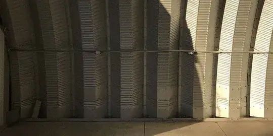

The outlets will be attached to the conduit and mounted similar to the installation in this photo.
THIS
One difference is my shop has the continuous hoop connections up at the 3 foot level allowing more bolt holes (like the lowest part of this picture). The Conduit will be hung on P Clamps every 2' attached to the existing metal bolts holding the building "hoops" together.

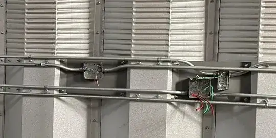

After-report: Some more detail on How I ended up running along the Quonset hut interior. (The small handy box is just for splicing to make the pull easier) And yes there is a ground wire even though its not supposed to be required using EMT; however My inspector wanted it in [see this question: https://diy.stackexchange.com/questions/207090/conduit-for-ground-in-metal-shop ]

I ended up riveting the boxes to brackets and bolting those to the existing "grain bin" bolts holding the Quonset Hut Hoops together. Then ran EMT through them anchored to other bolts via P-Clamps. An important note: The boxes need to be secured rigidly, not merely hung on the conduit and supported by conduit (this would not be allowed)
I posted a picture of the final configuration in the question.
