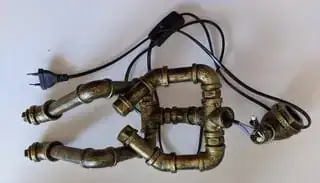

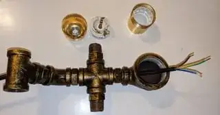

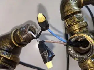

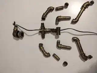

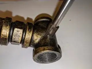

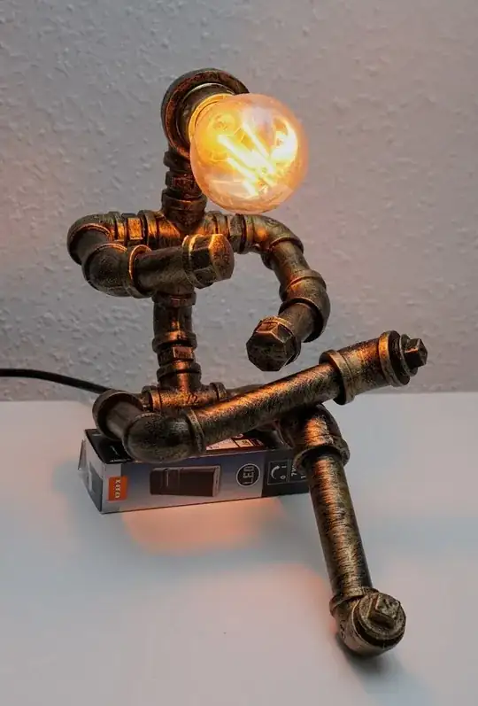

I bough a steampunk robot lamp from ebay. It is made out of (painted) metal fittings. After receiving it, I was a little concerned regarding safety and disassembled it. The plug suggests that this is a class II appliance, but the individual wires aren't double insulated and just connected via wire nuts. Is this safe? If not, what would be the best action?
I couldn't find any CE mark on the lamp. They also supply a super cheap looking 5W LED bulb, which has a CE marking on the package (but not on the bulb).
I kind of expected that this item would be safe, because it shipped from the Netherlands and therefore should conform to EU safety standards (it isn't like I'm directly importing it from China).

It's dangerous. You've spotted one important flaw but it can combine with others to make a really dangerous product.
I originally suspected it was made in Europe by someone with more interest/knowledge in the sculptural aspect than the electrical one, but I've since spotted contact details in China for the seller. Either way it shouldn't be sold.
Here's why (as I only have a little training in designing stuff for mains, and haven't inspected it, this list isn't exhaustive):
  • It needs be earthed (assuming the metal really is metal and not plastic).
  • Wire nuts are rare in Europe and any decent solution shouldn't need tape.
  • Secondary securing on the wires near the joints is a good idea, even required in some cases but needs to be much more solid than tape.

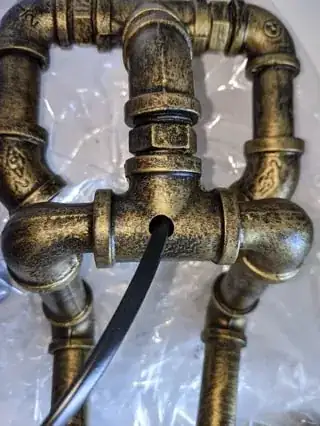

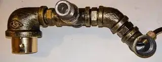

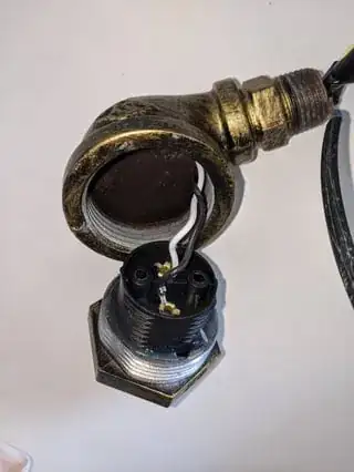

  • I doubt the wire is properly strain-relieved where it goes into the assembly. This is now confirmed by the 4th picture. The wire nuts will take the strain of any pull on the cable, and the edges of the cable hole can abrade the insulation.
This adds up to a dangerous and easily foreseeable failure mode where you trip over the cable, rip the live out of the wire nut, it touches the pipes, making them live, you pick up the lamp, you wake up in hospital - if you're lucky.
I've been known to cut corners for something I'm using myself, but not to anything like this extent, and certainly not for something that's going to be used by others.
These days the preferred solution would be an external low voltage power supply (complying with the regulations and safe on the output), but it could be built safely for mains operation - it just hasn't been.

I finally fixed the lamp. It was a little more complex than I initially anticipated. I decided to run the lamp on 230V, because it is much easier to get 230V E27 bulbs than 12V. It is nearly impossible to find nice looking 12V E27 dimmable LED bulb. I used the following items:
  • brass screw-in E27 light socket with earth connection (3,56€)
  • 3x0.75mm2 cable with Schuko plug and switch (4,98€)
  • brass strain relief with M10x1 (3,45€) thread
The following steps were necessary. I additionally disassembled the arms and legs, but this isn't really needed.

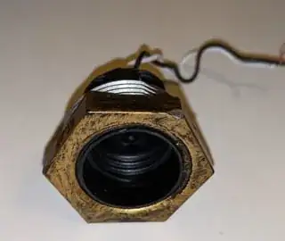

  1. Unscrew the old light socket from the head of the lamp, remove the cable
old light socket
  1. Widen the hole in base of the lamp to 9mm. Use M10x1 tap to thread the hole at the base. If you don't happen to own a M10x1 tap you have to fork out another 15€. Regular M10 has a thread pitch of 1.5mm.
tapping hole
  1. Put the strain relief on your cable and pull the cable through the lamp. A string proved to be helpful.
cable through lamp
  1. Wire the light socket and then screw it into the head of the lamp. You'll need to pull the cable back through the entry hole. Then you can screw the strain relief into the base.
wired lamp
  1. (Optional) Replace switch with dimmer. Nice ones with proper fuses and filtering against EMI can be expensive. I forked out 38.99€ for a rather nice one. Cheap one start at 5€.
  2. Get a nice light bulb. I got a super warm white (1700k) dimmable LED bulb (6W, 500lm), which fits super nicely. Especially if dimmed.
finished lamp
Was it worth it? Maybe. The lamp looks nice, but it took quite a few extra supplies and labor.
