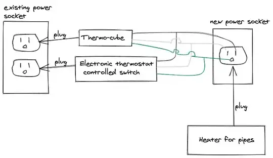

I have an electrical wiring question.
Background: I'm building my house by contracting out the daunting parts. Through a lack of good communication with the plumber, my plumber ran most of my PEX pipes through the crawlspace under my house instead of the walls. I live in central Missouri, so the temperatures in my crawlspace will likely go below freezing during the winter. I've insulated the crawlspace, but I expect to need a small amount of electrical heat in the crawlspace to prevent the PEX pipes from freezing.
So I need a power socket that will reliably turn on once the temperature gets close to freezing, then turn off once the temperature warms up a bit. Let's say roughly 35 to 45 degrees F. I've found multiple cheap devices that will accomplish this, like the "Thermo Cube" and several products on Amazon (search for "temperature controlled outlet"). You plug them into a power socket, then you plug your heater into them, and they turn some relay(s) off/on depending on the temperature, I suppose. This seems like an easy solution, but I don't want to trust a cheap device with my pipes freezing. The reviews say that they fail after some years.
So, I want a more reliable option, and I think I can accomplish this by purchasing two different temperature-controlled switches and wiring them up in parallel for redundancy. Even if one switch fails (by not providing power when it's freezing), the other switch will provide power. Is there a way I can do this safely?
Here's what I'm proposing: I have a professionally installed GFCI outlet box in my crawlspace, which has 2 plugs. I'd like to install one temperature-controlled switch into each outlet, then wire the outputs of these 2 switches together into a single new outlet.
an electrical wiring diagram showing a thermo-cube and an electronic thermostat controlled switch
If the 2 source outlets came from different AC sources, or if the phase was mixed up, I know this would be a recipe for disaster. But if I can confirm that the 2 outlets have the same phase (i.e. the hot and neutral wires aren't swapped), and I keep all the electrical work tidy and capped off, it seems like this should be fine. Thoughts?

No, you can't do anything like that at all. That's a suicide cord.
Meaning it has 2 plugs on it, and in certain conditions the prongs of one can be unplugged and live. Nothing should ever have 2 plugs.
Remove the "plug-in thermostats" from the equation - they're cheap anyway.
Use hardwired thermostats -- those can be paralleled in the manner you are thinking of. And much higher quality.
Speaking of cheap, you should not be using cheap heaters that plug in. Again use hardwired heaters that are made for long-term use and UL-listed to be run unattended.
Also, consider simply having 2 heating devices.
If the readily available quality hardwired heaters (e.g. Cadet, $40) are too high power for what you want, remember you can run a 240V heater on 120V and you will get 1/4 the power. For instance if you want 250W, a 1000W Cadet heater will work great.

I don't disagree with the other answers, but if you really want to do something like in your diagram, what would would want is for the two thermostats to switch a low voltage like 12vdc or 24vac to then power a relay that would switch power to the heater. That way, you don't have two 120v switches that are connected together making a dangerous situation. You just have harmless low voltage that turns on a relay and is isolated from the dangerous mains voltage.
JPhi1618
