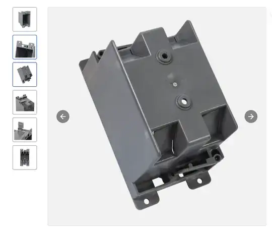

If your walls aren't too thick, you can use an "old work" electrical box to avoid having to screw in the plaster, which has wings on the back that fold out and suck the box to the wall when screwed in. enter image description here
Unfortunately, its not very easy to know where studs are behind lathe and plaster, so if you make your hole right over the center of a stud, you'll probably have to move your hole over and repair the wall to the side of your new outlet. If that happens, you can likely just screw a small piece of drywall onto the stud and mud over it.
