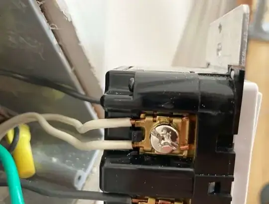

Instead, I just connected the two ends of the neutral wire by putting them into the same neutral terminal on the switch, under the same screw (see photo). The switch appears to work normally.
neutral  wiring  image to illustrate problem
But some quick Googling around says I should never put two wires into the same terminal. Why is this? Is there anything dangerous about my approach? To me it seems logically equivalent to the pigtail approach, i.e. the current still has the same paths to flow through. What am I missing?

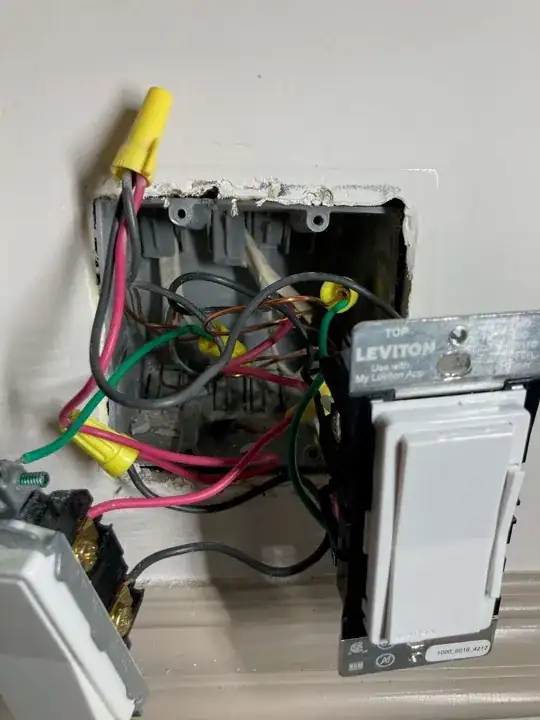

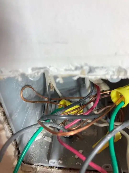

EDIT: adding two photos of the back of my junction box since some people asked. I know it's a little hard to see, but there are two bundles of cords entering from two ports at the top of the junction box. The bundle on the left has three wires: black, white, and unshielded copper. The bundle on the right has four wires: black, red, white, and unshielded copper. Before I installed my new smart switch, the two white (neutral) wires were connected together with a wirecap. Thank you for the help!
junction box (overview) back of junction box (close up of entering wires)

"Never" is a bit strong.
This is not a plain "screw terminal" where that would be true. This is a "screw and clamp" and appears to be designed to correctly hold 2 wires, so you are good. That extra bit of brass between the screw-head and the back plate is what makes the difference, along with the two grooves to hold wires in place.
