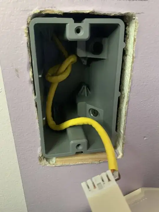

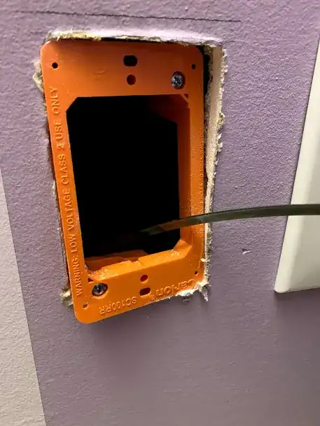

I want to run network cable into a bedroom and was going to use one of those Low Voltage Wall plate and cat 5E wall plate over it. While trying to install low voltage wall plate, instead of tracing inner sides I traced outer sides and cut a wider hole than I needed. What are my options to installing wall plate. I was considering attaching wall plate to drywall cut edges using screws. Would that work ? There is also a stud to the right side of the hole. Not sure if I can use that in some way to fix the hole. Here is the picture of what I am talking about.

Finished Job
Box attached to stud

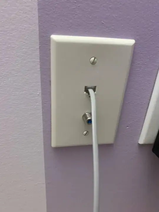

Finished Job, wall plate just enough to cover the whole thing...

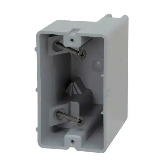

If you are right up on the stud, a Madison Smartbox will fix this
Madison Smartbox
The smartbox might not be exactly the size of your opening, but the faceplate will cover up the gap.
Cut a hole out of the box for the cable, maybe 3/8" or so - don't use the built in clamp, it will mangle the network cable.

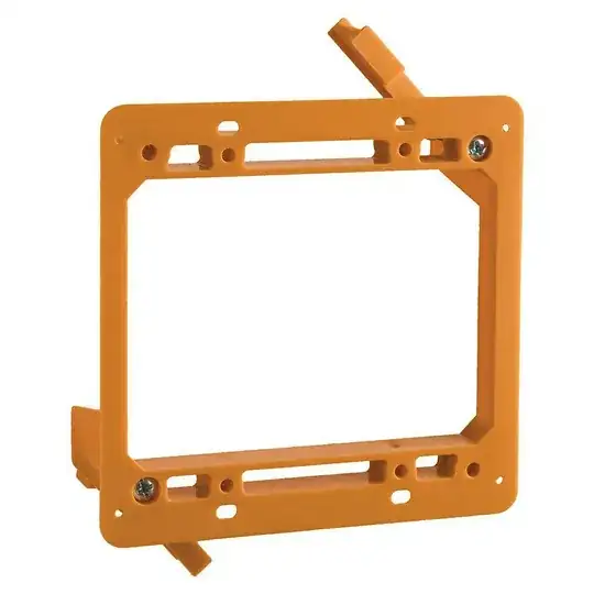

You could possibly expand the hole on the left and a little bit to the right and use a 2-gang box.

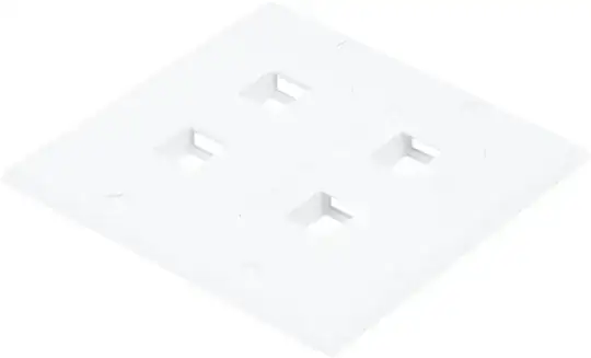

Then you'd use a 2-gang keystone plate for your ethernet jacks. enter image description here
https://www.amazon.com/Monoprice-2-Gang-Wall-Plate-Keystone/dp/B004C4ZXBG
Add blank keystones as needed:
https://www.amazon.com/Cable-Matters-20-Pack-Keystone-Inserts/dp/B01AYKR63O
Just for clarity, the hole you would need to make wouldn't be as tall as the existing hole. You'd need to expand on the left and right sides enough to give the clamps something to hold on to.
In the figure below, the black square represents the existing hole that is too big. The red square represents what you would cut to add a 2-gang box.
