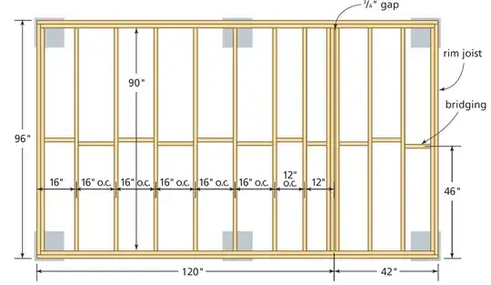

I'm currently building an 8' x 13.5' shed with a loft. Here is what it is supposed to look like (according to the plan):
planned shed floor

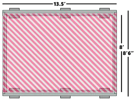

For a few reasons, the floor frame is too wide. I poured the piers slightly wide, and I couldn't find post-to-beam connectors for 6" posts to double 2x, so I used 6" to triple 2x.
I have already installed joists and blocking as shown in the picture above.
The 13.5'-long beams are each composed of three built-up 2xs. The distance between the outer edges of the innermost 2xs is 8':
shed floor
I assumed I'd be fine to build my 8'-wide shed on that red space and have a two-2x "lip" running along the sides of the shed. My next step would therefore be to screw 4x8 plywood subfloor so that it covered the innermost 2xs only.
However I'm wondering if this is safe. As I build up, will the load still be distributed laterally across the beam?
I'm hesitant to build to the full width because my materials were ordered with the 8' dimension in mind. I think building to the outer edge of the second 2x on both sides (total width 8'3") would be as far as I could go without pieces coming up short.

structurally it looks ok. (assuming you'rte going to fill that 3/4" gap or put blocking in there)
8'x13'5 was going to take 4 sheets of plywood sheet 8'5x13'5 is still going to take 4 sheets.
Either use the off-cuts to fill the ends or join sheets end to end
