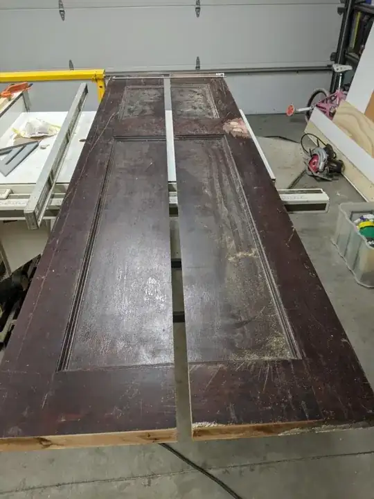

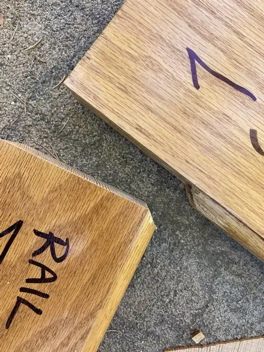

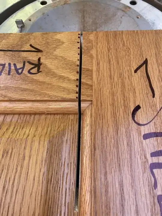

Needed a door that matches that the doors from 1940s in my house. So I bought a 30" door on Craigslist and cut it down to 23" by cutting out the middle of the door as you can see in the pictures.
I'm faced with two decisions that I would like some expert opinions on:
  1. My initial plan was to install a new panel, but now I'm wondering whether it's possible to join the two halves of the old panel. They are 5/16" (or 11/32"). Is that enough thickness for some kind of rabbet joining strategy?
  2. As far as joining the two halves of the door together, I have three strategies in mind:
    a. Glue them straight up
    b. Use dowels
    c. Drill the entire 23" width of the door in three places and use 1/4" all-thread.
What would you recommend? enter image description here enter image description here

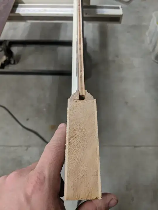

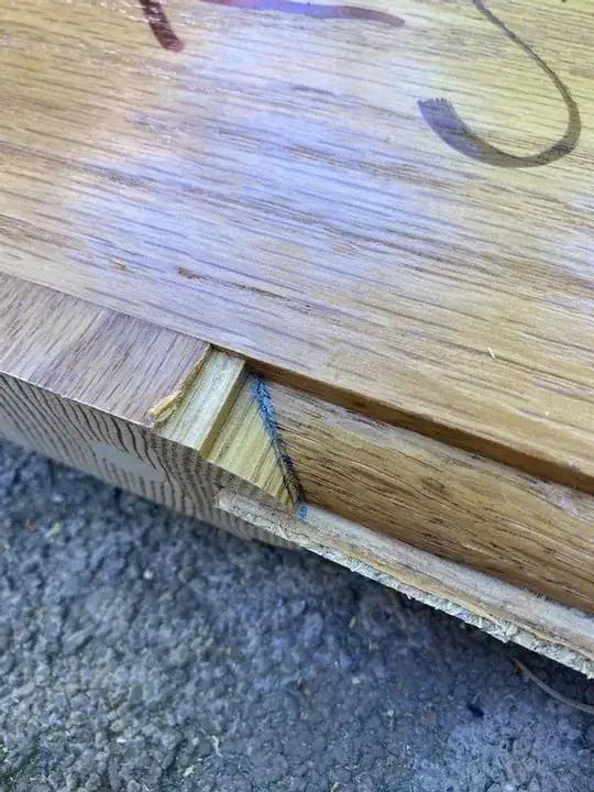

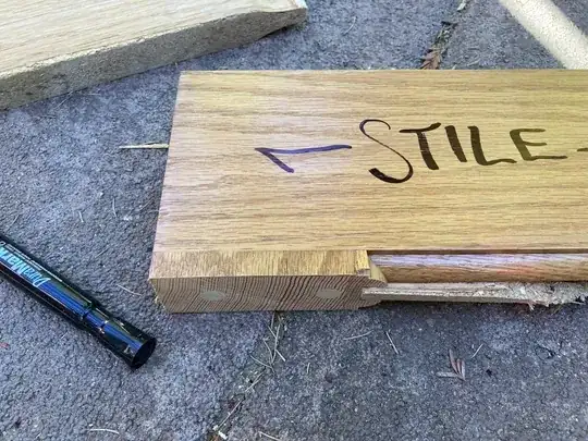

Here's a series of pics that show what I'm talking about above.
Starting point. Sorry about the rotation.

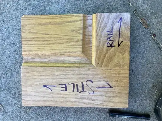

Rough cut the rail. Don't cut any of the molding on the stile.
Mark where the rail copes over the molding on the stile. You'll cut that part of the stile later.

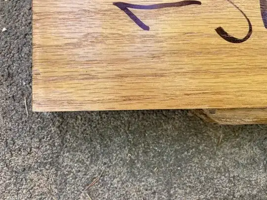

The molding on the stile runs all the way through under the coped rail. Somehow, chip/cut away the remaining rail.
You can do part of it with a chopsaw (granted, awkward with an 82" stile and impossible for the midrail), but don't cut past your pencil line. You'll inevitably be left with some wood that the chopsaw won't touch, so chisel/ multitool/ whatever to clean that flat.

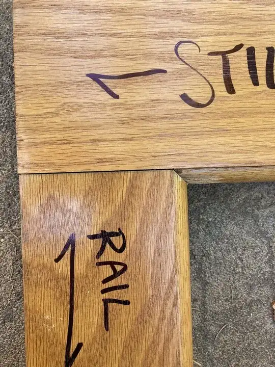

Cut the miter that you marked with the pencil earlier on the stile molding. (Don't do what I did and bust off some of the molding while demolishing the remainder of the rail.)
Cut the rail to width and miter the molding.

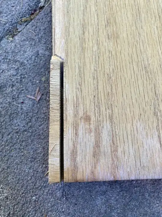

Your parts should go together perfectly. Join them as described above.
