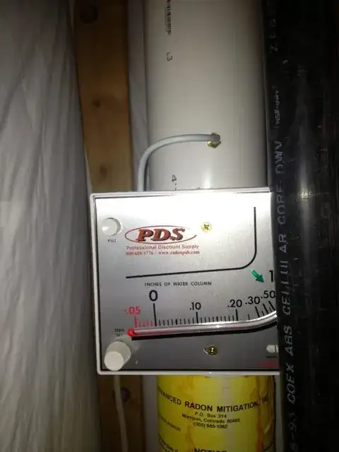

We purchased a home a few years ago and it has a radon mitigation system. I just happened to go downstairs and look at it and noticed this reading. What should I check? Should I be alarmed?
meter photo
EDIT
Thank you for the link to the manual. The fan is on a pipe coming out of the house and is plugged in to the outlet on the side of the house. I can't tell (tried both listening and feeling for vibration) if it's running and I checked to ensure that the breaker hadn't been flipped.
As for checking the oil - I haven't quite been able to figure out how to do that.

To check if the fan is working, you can put a plastic bag over the end of the exhaust pipe and see if it inflates.
Gauge oil is just the orange fluid that goes in the manometer (pressure meter) tube that indicates the pressure difference being driven by the fan. If it is missing or low, then it could give the negative reading. It should go to zero when the fan if off (as long as the wind isn't blowing too hard).
Even if the bag inflates, it may not be creating a strong enough pressure difference, so you should make sure there is the proper amount of gauge oil in the manometer.
