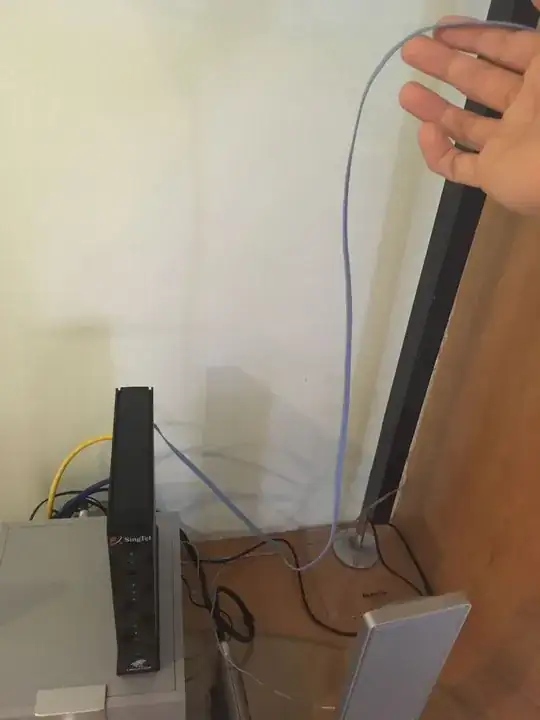

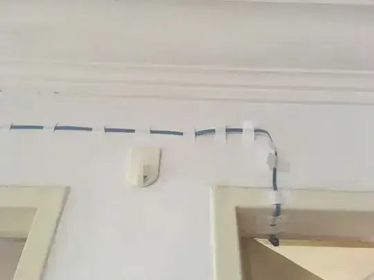

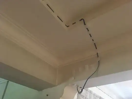

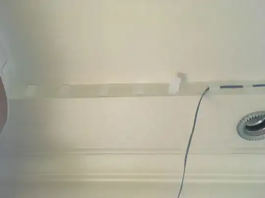

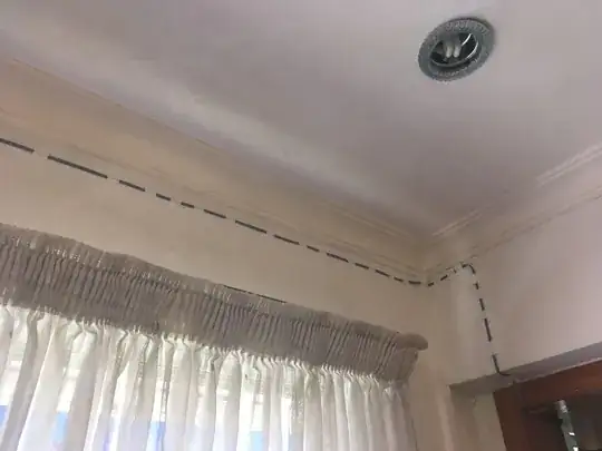

After successfully untwisting the very twisted Ethernet cable (thanks @Ecnerwal) I ran the cable to my room. However my parents were not keen on it being on the floor as it posed a tripping hazard. So I used a lot of sticky tape to tape the cable from the router all the way to my room via various walls and ceilings.
This worked well for about a day or so before the sticky tape became not-so-sticky and the cable started to droop and fall off in places. I attach photos:
enter image description here enter image description here enter image description here enter image description here enter image description here
So I'm looking for a slightly more permanent solution here. I know there are some U-shaped panel thingies (can you tell I'm a seasoned DIY professional??) that might work if I can figure out how to stick them to the walls.

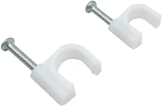

My recommendation is cable clips/staples. There are plenty of varieties, but generally something like this:
cable clips
There are some with a single nail and some with two nails. For Ethernet (and similar), a single nail is strong enough. If the main part is white and you switched to a white Ethernet cable then the whole thing would come pretty close to "background noise" on a white wall. But if you don't care about the look, stick with the existing cable, it is just fine.

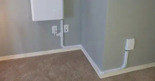

Another option no one has mentioned is to use cable raceway
Raceway example
The raceway itself will come with adhesive, or sometimes be nailed into the wall. It's more expensive, but the end result will look much nicer than tape or staples, and be more flexible for future expansion. For even more flexibility, you can terminate it to an ethernet jack:
Ethernet jack
By the way, regardless of what solution you choose, you should NOT use flat cable longer than a meter or two. They are infamous for having EMI (electromagnetic interference) issues. Spend the $100 to buy a spool of CAT6 (plus a crimper+heads, if you don't go the jacks route). You'll be glad you did.

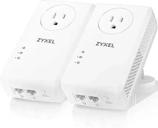

  2. I'd like to offer an alternative to having a long running ethernet cable. Powerline adapters!
A Powerline adapter is a device which uses your homes electric wiring to transmit communications signals. The adapters (at least two) plug into your wall sockets and use Ethernet cables to connect to your router at one end and your device at the other (TV, games console, PC whatever it may be).
I have used four in several apartments and houses with no issue. Every device that can use ethernet, I hook up to my powerline adapter to get better signal and reduce the number of devices on my wifi network.
When looking into them, I recommend the following features
  1. A pass through port so you can still use that outlet
  2. Two ethernet ports so that you can still have a free ethernet port from your router
Here is a pic of what mine looks like Zyxel Powerline Adapter

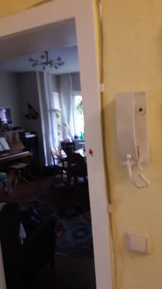

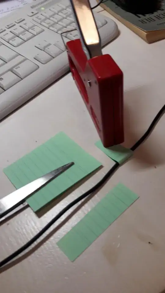

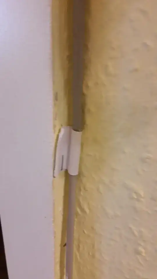

Hmm, when I see your first try then maybe my improvisation-style is sufficient for your needs. If appearence is not critical and money-is-out, instead of using tapes I use my stapler and cut rectangular pieces of card-paper to make a loop around the cable keeping a tongue to be stapled to the wall.
The problem of destructive tapes doesn't occur, and the holes in the wall/carpet/wood are so small that they are nearly invisible when the cable must be removed one day.
Here three pictures:
I took green color card-paper here to makeit better visible for the reader. Make the "tongue" (? english noun?) as small (or long) as you need for the staple.
Here is one example where I fixed my ethernet cable along the door. Very primitive, yet very effective; nearly no cost after you have a stapler in your home-office...
So looks the door... Of course it could look better, it's having this status at least 10 years, only this year I'll be going to improve that wall & door for better optical appearance... image3
