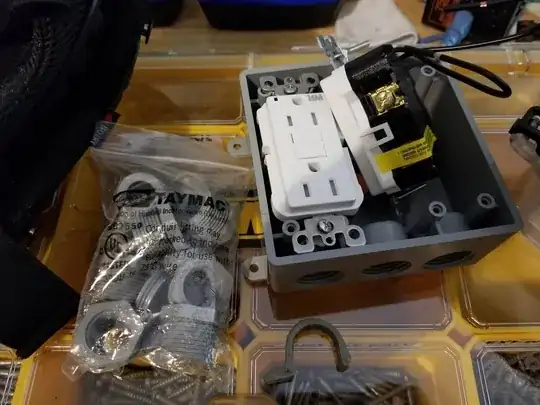

Anyway, first picture is what the box looked like with a couple duplex receptacles in it. Hopefully, you won't need a new box; but if you do, they come with plenty of plugs and conduit bushings. first picture

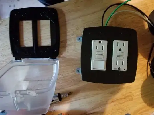

Then I have the parts that came with the cover; that's the cover itself plus a gasket that makes it watertight. weatherproof cover parts

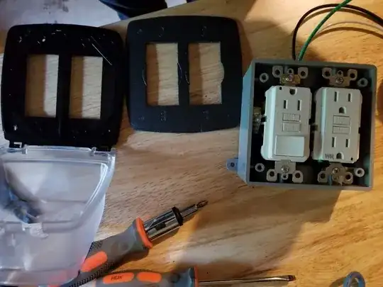

Here's what the box looks like with the gasket fitted: gasket installed
And now with the cover attached using four mounting screws: cover attached

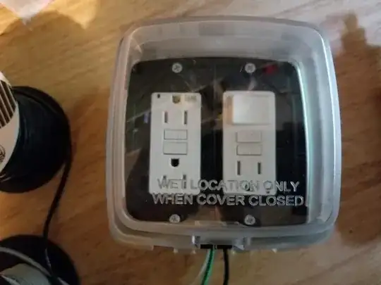

What it looks like when closed: enter image description here

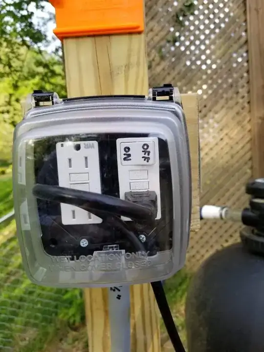

Finished, with a cord plugged in: finished and cord plugged in
