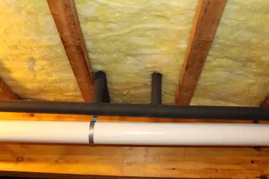

First time owning a home with hot water heat, and studying the plumbing the basement, I notice that the living room/kitchen zone that has a run of baseboard, a kick panel unit, and several floor units, doesn't have them daisy chained as I expected, but each one is in parallel with the main loop. The attached photo shows the "drop" for one of the in-floor units.
Is this a typical practice when a zone has multiple drops?
I can see the benefit of this, in that each successive device doesn't lower the overall temperature as much as if they were "one out, two in" plumbed, and this also allows for more overall flow through the system rather than being restricted by the smaller devices, but it leaves me wondering how enough water goes through the individual devices, since it seems that it would be easier to keep flowing through the larger-diameter main loop than taking the 1/2" route through the baseboard or whatever. The loop pipe seems to be 1", and the drops are 1/2" copper. The overall system has a single circulator and zone valves for each thermostat-controlled zone.

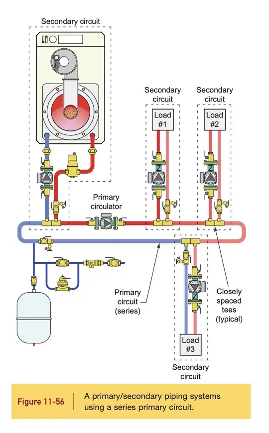

Based on this photo I would think that this is plumbed using monoflow (diverter) tees.
In a primary/secondary loop system the secondary loops need their own circulator but OP says the system only has one pump for all zones.
Since the "supply" side of the drop and the "return" side of the drop are consecutive (no other supplies between this supply leaving the trunk and returning to it), it also suggests that if this was a primary/secondary loop system then each secondary loop would need to be in series. This is an inferior design if all secondary loops are designed to operate at the same temperature.

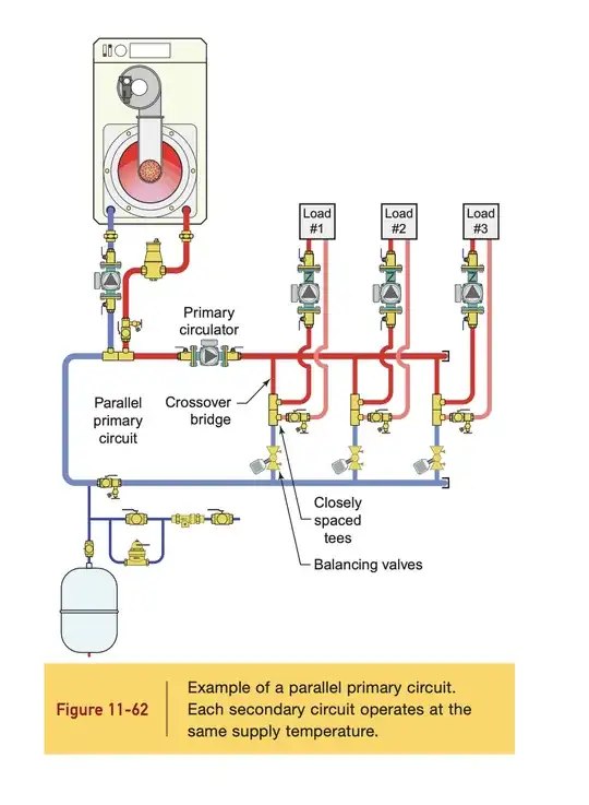

A better design is to plumb secondary loops that are supposed to operate at the same temperature in parallel:
Hence, you may be able to discern based on how evenly your system heats if this is how it is plumbed.
