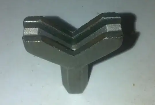

I have bought a bits set and there is this bit: a bit with a groove
It is a Y shaped bit, and there is a groove on the inside of the branches. The angle is approximatively 90˚ (a little more).

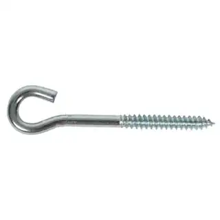

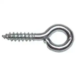

It's a bit for screwing in eye bolts, or hooks.
eyebolt open loop or hook screw
  • Attach the bit to your driver handle or power driver.
  • Fit the eye bolt into the groove.
  • Screw the bolt in/out, without hurting your fingers.

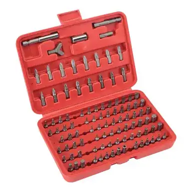

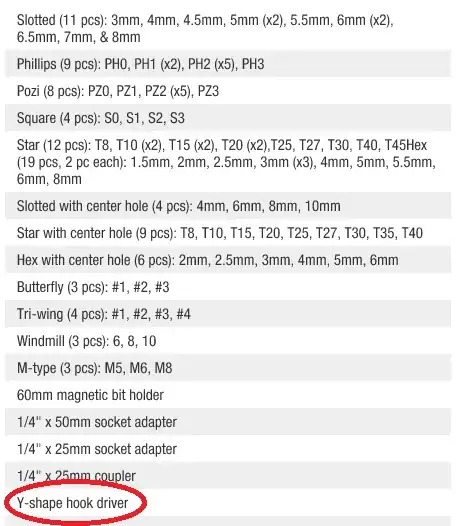

The list of bits in this set, lists it as a "Y-shape hook driver".
100 piece "security" bit set and plastic case screenshot of available bits highlighting Y-shaped driver
Also can be used for wing nuts.
