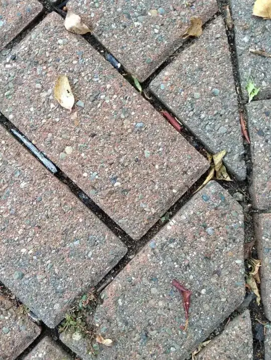

I have been told that there is special "sand" to re-secure pavers that is weed resistant.
Is it something different from the normal paver sand (to secure patios) you can buy at the Home stores?

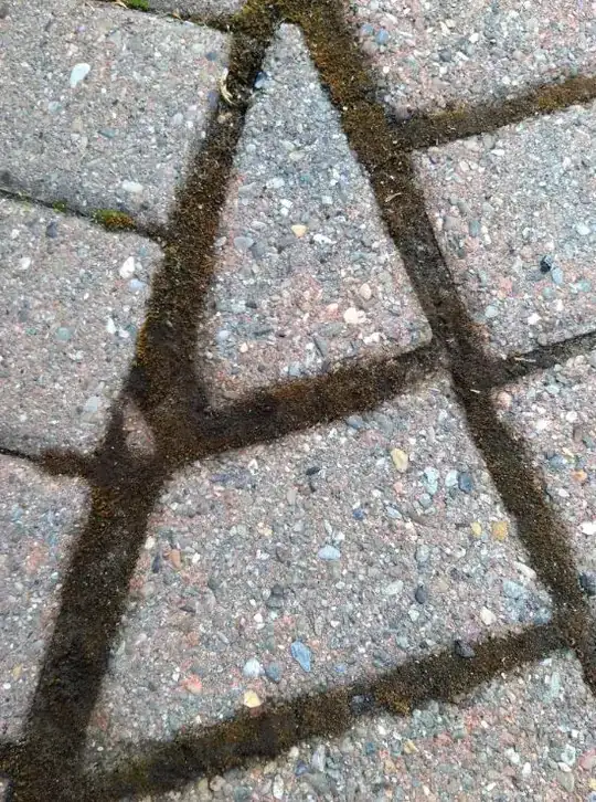

While you can get sand to try to prevent weeds, keeping the gaps between the pavers as small as possible is going to work better, especially long term. Also, I'm sure any weed prevention sand isn't design for the large gaps you have. As mentioned in a comment, any weed killer in the sand isn't going to last very long, so proper weed removal tools and regular spraying is still going to be necessary.
Small gaps will help prevent seeds from taking root, as well as minimizing the water getting to the ground underneath.
It's a lot of work, but your best bet is to remove the pavers, remove the weeds, smooth out or remove the remaining sand, and re-place the pavers. Then you can put a border around the path to keep the pavers in place and re-sand everything.
Once you get weeds in between pavers, it's pretty hard to keep them from returning. You need to get to the roots to prevent regrowth. You also need to remove or destroy the seeds to prevent new sprouts, and weed seed is generally notoriously small and resilient.
Looking at the 2nd pic, you have some pavers that are tight and some that are very loose. The tight ones won't accept the new sand well since it already has some sand, plus the existing weeds. And once you get rid of the weeds and sand the large gaps, your path will look all kinds of weird with that kind uneven spacing. In that 2nd pic alone, there's 3 distinct amounts of spacing that will be noticeable from any distance.
At least with existing pavers, you shouldn't have to cut anything to fit, so that'll save you a lot of time, as long as you keep things ordered and can put them back in the same order/location/area they came from. You can use some sidewalk chalk to mark things to make it easier for yourself. It's designed for pavers like this as well as being fairly easily removed.
