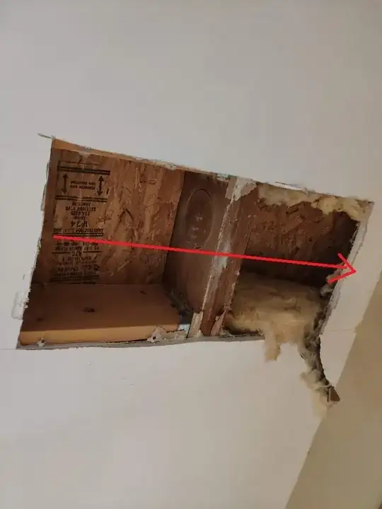

I'm working on my kitchen to add a range hood that goes outside the house. I'm putting the 6" exhaust pipe in my ceiling, between my 1st and 2nd floor, going in the direction of the ceiling joists, as represented by the red arrow in the next picture:

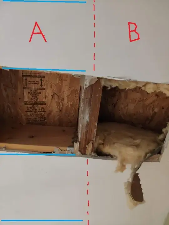

While going this direction however I found 2 boards put together of at least 12 inch height, probably more, in perpendicular direction of the other joists, which marks the end of the inside of the house (Siding would be attached to the other side of the board).
As you can see in the following picture, there are 2 sides in the ceiling:
Side A is inside the house, the blue lines are the studs in the ceiling holding the second floor. Side B is a part that extends a bit out of the house (backyard), there is nothing on top of it, just a small roof on the backyard.
I want to put the exit of my exhaust on this small roof. My question is: Is this, is this a loading bearing joist? Is it safe to put a 6" hole in it (you can see I started it before realizing what I was doing)? What can I do to safely put the exhaust through it?

That joist is carrying something, even if it the weight of the material that make up that part of the house. I would say it is more than that since the new 2X with the framing anchor is attached to it, is telling me it is passing the load from the new 2X onto the one you wish to drill.
Now onto drilling dimensional lumber. Code only allows you to drill a hole that is no larger than 1/3 the total height of the material you plan to drill. 12" material, 4" hole maximum. There are metal brackets available online that will allow larger holes to be drilled.
10-23 edit
If I might add, and it should have been obvious earlier...That doubled joist is actually a beam, not a joist. Those follow a more stringent rule for drilling. I do not know what the largest allowable hole is, short of a 3/4" hole for electrical wiring, but that is all I do know. The mention by the OP about the outside roof and inside the house, that beam is carrying the outside wall above it with possibly the roof portion as well

As J comments, this is not a joist, it is a beam on which the joists are hung. Likely there used to be a load-bearing wall there that a prior owner had removed to enlarge the space. They could have opted to have the beam under the joists, which would have allowed space above it but would have reduced ceiling height. Instead they opted (surely at higher cost) to cut it into the joists, allowing a nice smooth ceiling, but blocking crosswise space. I have several such beams in my house, following renos, and I have some wiring runs that are crazy roundabout to avoid going through them.
This kind of work may have been custom-engineered based on load estimates. It's carrying a lot of weight. I'd be loath to drill 3/4" through it for wiring, never mind 6" for an exhaust duct, especially if (and it's hard to tell from the photo) it's engineered lumber and not just two-by spruce/pine/fir.
At either end of this beam, possibly buried within the finished walls, will be posts taking the load down to the house's foundation. If one is in the middle of the house, it will be on a load-bearing wall or on a post going down to solid ground. Find those and make a note that those are important, too.

Clues that it is likely load bearing are the sheer size (two side by side planks, you don't do that without a reason) and the fact that it looks like it's supporting the studs. What is the span between walls if you follow its length? I don't think you can safely put a hole in that without reinforcing it, and you'd need an engineer to tell you how much reinforcing is necessary.

You not allowed to make that type off hole there is double LVL beam supporting the second floor exterior wall

ABSOLUTELY NOT!!! That’s a double LVL, which is much more expensive than dimensional lumber, and only used in load-bearing situations. Even a small hole of less than 1” would require an engineer to sign off on it first. Since you’ve already begun drilling, I highly recommend having an engineer look at the damage you’ve already caused to make sure you don’t need to repair it. This is why framing is not DIY.
Looks like you’ll need to figure out another way to vent the exhaust. Sorry for the bad news, but better to find out this way than to have seriously compromised the structure of your home.
