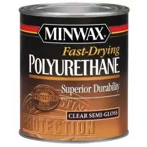

If you like the current look of the wood, then you should not stain it, as any stain will alter the color. 2 or 3 coats of clear polyurethane will highlight the look of the wood without altering the color.
I suggest a clear, satin finish, as glossy would make your table look shiny.
Such as: enter image description here
