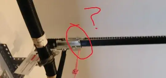

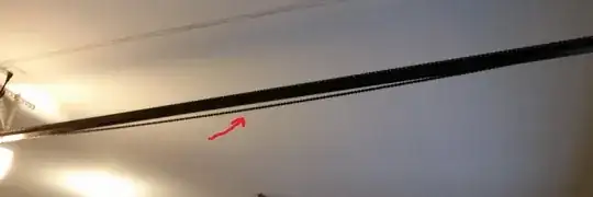

I noticed today that the chain on my garage door seems to droop a bit on one side when the door is closed. I feel like I would have noticed if it was always like this (new unit, about 1.5 years old).
Is this okay/normal? If not, is there a process to tighten it? Seems like it's been nosier lately!
showing drooping chain
where i guess chain may be able to be tightened?

Yes, that's normal because the drive is putting some tension on the other side of the chain and that leaves a bit of slack on this side.
