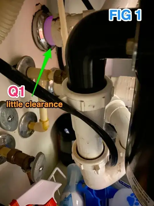

  1. There is little clearance from either one of the drain pipes coming from the wall as well as being glued to a wye and a tee? ( respectively ) So I don't know if cutting the fittings is advisable.

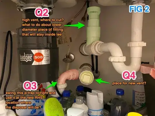

  2. The vent is very high at this point and will definitely be an obstacle for the newer deeper sink So I don't even know how to deal with it, should I cut and recap? can I cut and recap? If I cut won't the lower diameter portion of the existing fitting be stuck in there?
  3. What could I do with the p-trap coming from the lower drain's wye which I intend to connect to the disposal ( which again, I want to move to the RHS ) given that I think the trap would have to sit low-ish and the RHS drain is high.
  4. Where can I install the new vent IFF I can somehow figure out what to do about the other one, my Idea is to use the capped branch on the lower wye.

figure 1, question 1
figure 2, questions 2,3,4

Good pictures. You have an unusual configuration for that drain. Typically, there is only one drain line coming from the wall into the kitchen cabinet. That would have one trap and upstream of the trap are the sink, disposal, and perhaps a dishwasher drain (you don't appear to have one in this cabinet.)
What you have is not necessarily wrong, but if you search for garbage disposal drain on Google Images you will see many examples of more typical configurations. Yours could be like that if you re-orient the disposal and re-configure the drains to combine into one trap.
If it's easiest for you, you could use only the lower drain, and stop using the upper connection. It seems like you need room for a deeper sink and that may help.
Why is your sink drain unusual?
The gotcha question is -- why is your drain setup unusual? And why is that Air Admittance Valve (AAV) (not exactly a vent but it has a specific purpose) connected to the upper drain? Does this drain lack a proper vent at all? Check outside your house and see if there is a roof penetration for the vent above your sink or elsewhere in your kitchen area. If not, that AAV -- which is not a total substitute for a vent -- will need to stay in there somewhere downstream of the trap -- but you could cut some drywall away and see if there's room to relocate it into the wall cavity (just don't cover it with new drywall after; you cannot cover up an AAV because they have a limited lifespan and need to be serviceable.)

There are only a few things here that are truly important.
  1. Will the depth of the sink interfere with the AAV? If it does it probably makes sense to remove the AAV and cap the top drain. You only need one of the drains. When capping it leave as much stub as you can for possible future use.
  2. If you use the bottom drain it needs to be vented. If there is no roof vent or other vent present, using a tee you can add an AAV between the garbage disposal and the wall drain. Attach the tee to the wall stub using PVC cement. The other end should have a pressure fitting for the tailpipe from the P trap.

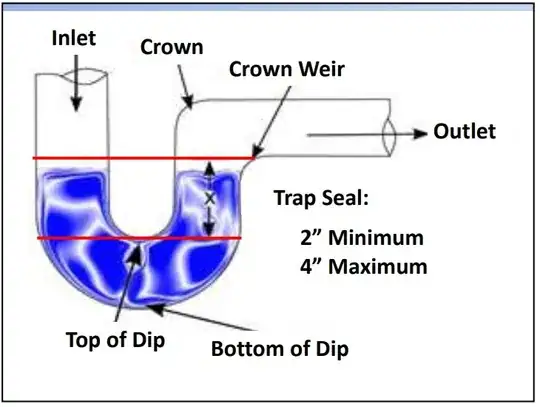

  3. You need to make sure that the P trap is set up properly with a proper weir and proper slope from the crown weir to the drain. See illustration.
Don't stress over how to fit the PVC drain pipe connecting to the lower wall drain. Drain pipe comes in many configurations, it has slip fittings and is easily trimmed if necessary. It is very forgiving - just check for leaks when you're done. Once you have the sink installed with the disposal, installing the PVC drain pipe will be the easiest part.
If the sink doesn't interfere with the AAV you can use either drain and cap the other.
