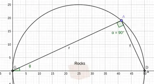

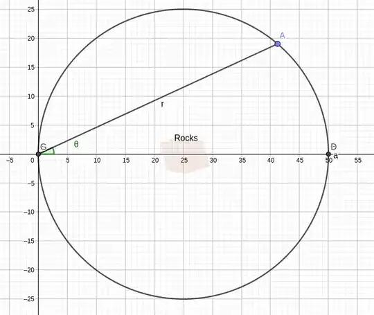

"Stand back I'm going to try maths" (misquoted from xkcd)
r = 50 cos(θ)
This polar plot defines a circle of radius 25 centred at the point (25,0)
This assumes that you can set up one point "G" 25 feet from the assumed centre of the rocks. Measure the angle θ and calculate r = 50×cos(θ). Measure that distance from the G in the direction of the angle and put a marker "A" down. Repeat for angles between +90 and -90. The pattern of markers will be a circle. You do need an initial point set up, but you only need to estimate one point
Alternately, if you can set up a diameter you can use the theorem that the angle on a diameter is a right angle.
If you have a diameter GD, choose point A so that the angle GAD is a right angle. The points so formed are a semicircle. This doesn't require any calculations, but you do need a diameter of 50 feet to get started. The total length of the rope (GA + AD) will vary around the circle (from barely over 50' near G or D to about 70' directly above the rocks). You'd probably want someone at both G and D to pay-out or pull-in the two lengths until you form the required 90° angle.

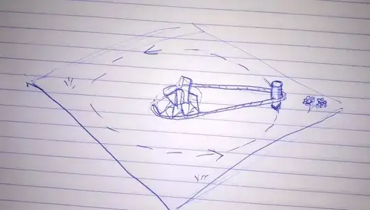

Approximate solution: Assuming it's a steady pile of rocks on a level field: use the whole pile of rocks as the center point. Take a rope, make it into a loop that has approximately the diameter of your circle (plus a bit extra) and trace out the circle. It won't be perfect, as your pile of rocks most likely doesn't have a perfectly circular cross-section, but practically, I think it would be a good compromise.
(Edit: to make the pile-of-rocks more circular, you can drive poles into the ground surrounding it.)

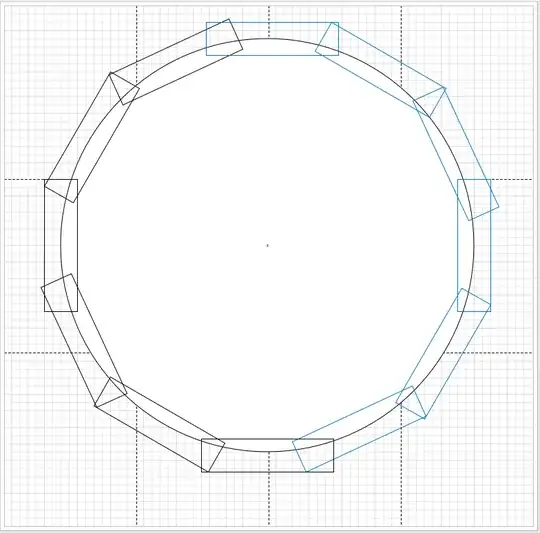

Poster is spray painting the ground..... Use a Template.
Mark a template where you DO have access to the center point. Accurate and no math....
Cutout the Template, on your scribe line.
Move the template where you want. Spray paint the cut edge for a clean crisp line.
Done.
a 25' circle, will only take 6 sheets of 4'x 8' materiel cut into 2'x8' pieces (Lauan,Cardboard,ChipBaord, etc), glue or Stapled together.
25' Circle with 12 2'x8' Segments for pattern
