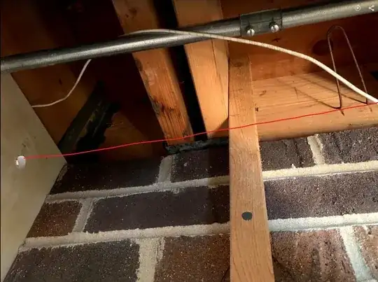

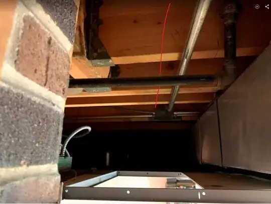

I am trying to run some cat6 cable in the drop ceiling of my basement. I want to run 3x CAT6-CMP cables that from what i understand should not rest on ceiling tiles.
From what i have read, the support needs to be attached to something other than the ceiling tile grid. J-hooks seem to be recommended/easy but i don't really understand where and how they need to be attached.
I have attached a couple of photographs of the area , i have highlighted in red the direction in which i want the cables to run.
Thanks

J-hooks are a good way to take care of those two practical concerns. The cables will just rest comfortably in the j-hooks. If you decide to remove, replace, reroute, or add cables, the j-hooks will make it easy - you can just lift them out, and lay them back in.
If someone is working in the ceiling, and the bundle gets snagged and someone yanks on those cables, it's less likely to damage the cables - they won't be creased on something like a staple or cable tie. And your install will satisfy most of those over-the-top standards, too.
You can screw j-hooks right to the joists. The little screw you'll use for small j-hooks, maybe a #8, won't weaken the joist. You can screw them into the face of the joist for bundles of cables running parallel to the joists. You can position them so only about half an inch of the j-hook is on the joist and the rest of the j-hook hangs down below the joist. If you need the cables running perpendicular to the joist, just bend the top half inch of the j-hook to a 90 degree angle, and screw it into the bottom of the joist.
The industry standards want you to limit the distance between j-hooks to 5'. You can go further than that and probably never have a problem - people cut corners with this all the time in commercial installs. Sometimes it's much easier to span 6' than 5' and unless there's someone very diligent checking the work, it goes unnoticed and nothing ever comes of it.
However in commercial buildings there's a lot more space above the drop ceiling, or you may be routing cables between bar joists 28' above the floor. In residential basements like yours, I'd prefer as little sag as practical so the cables are out of the way.
So I'd go with more j-hooks so you have less sag. If your joists are spaced 16" apart, you could try j-hooks 32" apart. You'll spend a few dollars more on j-hooks but less sag makes it less likely you or someone else working up there in the future will mangle those cables.

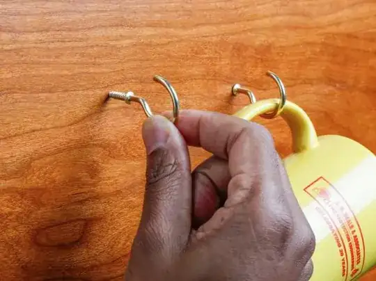

Simple cup hooks will suffice
$5 for a pack of 25.
enter image description here src
If screwing into the bottom, then at the first joist, you have two of them about an inch apart, and you face them opposite directions (not like in the photo). That way, to get the cable into them, you have to zig-zag it. This assures the cables will not escape.
Then every couple of joists, you have another hook, and alternate which way the opening faces.
If the cable will make a bend, face the openings outward of the bend obviously (won't work the other way).
These are trivially small and will not have any impact on the strength of a joist.
Note that I'm not talking about planter or light fixture/chandelier hooks, which are quite a bit bigger and justify a pre-drill and some sort of weapon to drive them. These are too small to power-drive, you'd either snap them off, or overshoot the mark.

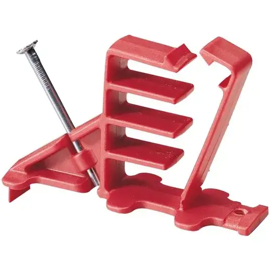

I like using these in my attic, even though they are designed for Romex. I like how they can clip multiple cables in.
Sometimes I replace the nail with a screw for easier installation.

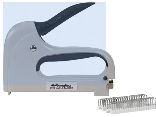

I usually use a wire stapler with appropriate staples.
They also make plastic cable staples that can be used if you don't want to invest in a wire stapler.
Either will work but the stapler is a lot more convenient.

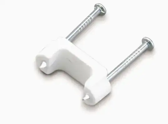

Cat 6 is roughly the same size as its RG-6 coax counterpart. Coax clips can be easily found everywhere and they drive in fairly easy to wood (nail-in or screw varieties). This clip on Amazon even mentions Cat 6.

The effective but cheap way is zip ties - also known as slip ties or cable ties. They are available in many lengths, but 300 mm long 4.8mm wide is about "normal" and you can get a pack of a thousand for $30-50.
Depending on the clearance above the joists, I'd loop one cable tie around the wood/metal, and then loop a second cable tie through it, which will hang at a right-angle. Leave the second one very loose, and then thread your cable through this lower loop.
A series of loops will hold the cabling off the drop-ceiling tiles and out of any insulation. Spacing between loops is dictated by the hanging opportunities in the ceiling void.
If you want to be fancy, use separate loops for each bundle of cables that does something different or services a separate space/room. The wires should not be tied together in a bundle.
Try and use the black ties which are UV resistant - they last longer than the white/translucent ones even when there's no direct sunlight. Ceiling spaces can get hot.
  • If your ceiling space is a plenum space - ie it is an air channel for ventilation, then there will be rules about the fire-rating of cabling that you can use in this space. However the photo doesn't look like an AC system's pleneum.
If you can't get a tie over the joists, its okay to staple the zip tie to the joist - as long as your staple won't pull out. You can even use fencing staples and a hammer, or staple into the vertical side of the joist to support your cable tie. Don't staple the cable to the joist though!
A loop of fencing wire works fine too, if you have no access to cable ties, though they're a little more scratchy.
Keep the wires relatively low - you don't want them running just underneath the roofing/flooring above, because heat rises. Also aim for a straight-ish run to save cable costs.
I would not drill through each joist - that is hard work for no real gain. Additional cables can be threadded later without issue, though try and run "enough" cable for your immediate and near-future needs.... running cable is hard work!
