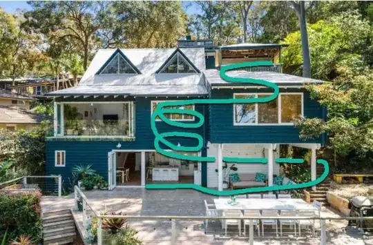

I have bought a new house (5 bedrooms on a steep slope). There is a road above with a double carport for the house which has garbage bins in it. The kitchen and deck is about 15 metres below the carport level.
I'm thinking of installing a zip line with an electric winch to transport garbage up and groceries down to the kitchen to save me lugging them up and down.
How feasible is this? Most winches I've found have a fairly short line length. Is it safe? Is it something I should get a professional in to

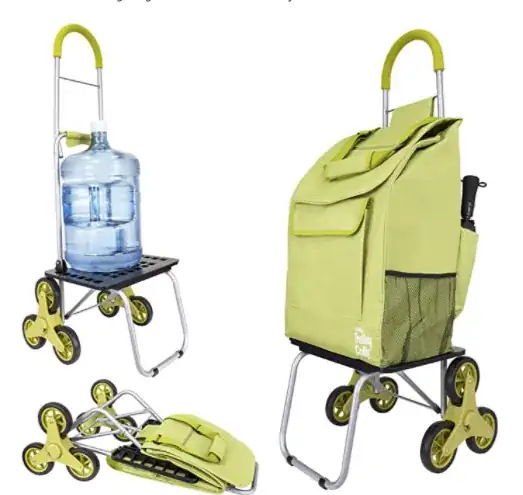

Or on a more serious note, perhaps you should just get one of these shopping buggies with stair wheels.
