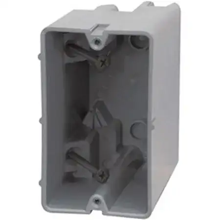

They make these boxes with preinstalled angled screws, without providing a product recommendation google smart box electrical 1 gang

The "smartbox" type boxes with the built-in angled screws inside
Madison smartbox
are more expensive, and have just a little less room inside for your wires and devices, but really easy to use, do not require a right-angle adapter, and easy to adjust the depth. They still have way more room inside than the metal old-work style boxes, which are tiny - barely big enough to fit dimmers, smart switches, and GFCI devices.
