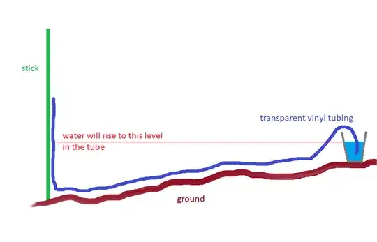

Use a 70 foot water level.
Here is a diagram of one.

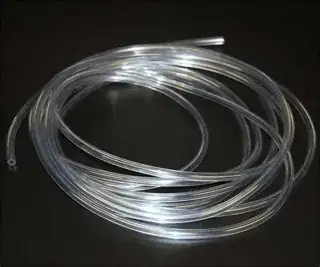

Use 1/4 inch tubing or slightly larger.
Fill tubing with water before submerging one end.
The container of water is required because a huge difference in water level at the stick end, translates to a tiny difference in the water level at the container.
That keeps the actual water level almost the same, no matter how much you move the stick up or down.
NOTE: the accuracy suffers on windy days.

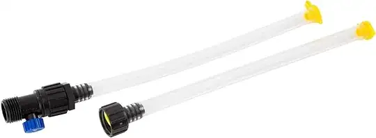

You want a hose with see-through sections at both ends. You can make that yourself, or buy a kit like this one from Mayes
water level kit
With that kit and a garden hose you probably already have, you can set your reference stake in the middle, and transfer your mark to every stake to the left and right, and get it dead on with the least chance for error.
