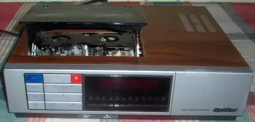

I'm building a computer desk and I had the idea to hide some speakers in a compartment towards the back. I'd like the speakers to pop up out of the desk on some kind of mechanism that rises up, kind of like an old top loading VCR, maybe something hinged at the back. I'm fairly mechanically minded, but I'm struggling to imagine a way to make something like this that doesn't need visible handles and I'd love it if I could open the compartments by pressing on the top and having it open at least a small amount. I know this is a long shot, but are there any products out there that could help me achieve this? I genuinely have no idea what search terms to use.
Top loading VCR

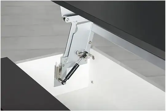

There are purpose-built products out there that are designed to do this.
Hard to show an example without it coming across as a recommendation, but you may want to explore something like this:
Table Top Fitting, Swing Up, Tavoflex
To stress, this is merely an example and not a product recommendation.
For my money, I think I'd save myself the frustration of trying to get something acceptable from a combination of push latches and lift-up hinges. Something purpose built is much more likely to "just work".

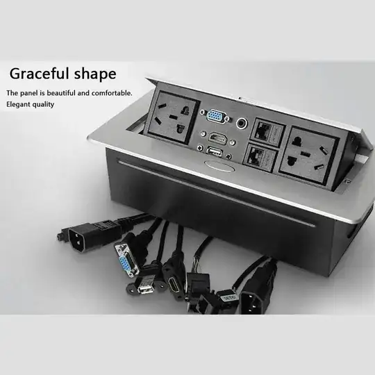

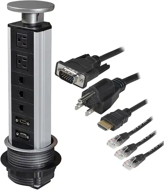

There are ready made desk items search Google for "pop up desk cable hidden". You could either modify one or may be able to buy an empty one.
Images from Amazon:Hinge type
Lift type
