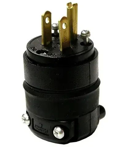

Another option - I will often re-terminate cords to get them the exact length I want, you could do the same to get a regular straight plug. A decent quality UL listed NEMA 5-15P plug is still pretty inexpensive. They're a little bulkier than I'd like but they're easy to use and very strong if you assemble it right.
nema 5-15p plug
