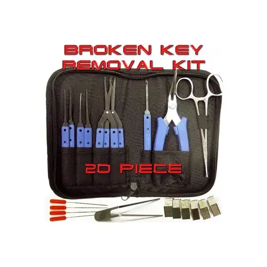

A locksmith would use a key extraction tool to remove the key.
Tool picture
