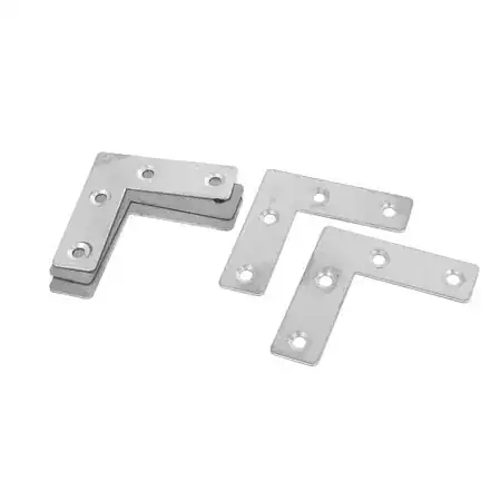

If you were able to find flat angle brackets:
Image courtesy of walmart.com. First somewhat small image I found for what I was after.
that were long (I'd suggest 12" legs or more), with legs that were only 3/4" wide so that they would hide against the edge of the particle board, then attach them with screws designed for particle board, you might have enough rack resistance to get this to stay upright for a while, but it will still want to sag and warp eventually.
You're going to need serious corner bracing (straight pieces or triangles that connect the top to the legs at about 1/3 the length of the top - roughly 20" across and 20" down) or something like a shelf support bracket or a full on back in order to keep this from collapsing.
