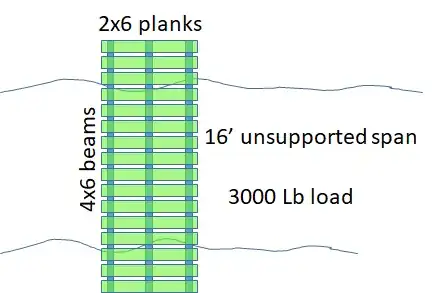

I think this is what you've got: enter image description here
Can you get 2x12s? or better, get an engineer to run the numbers. You will need to calculate the actual load and deflection and not just rely on flooring span tables since your load is very specific and not distributed over the entire span.

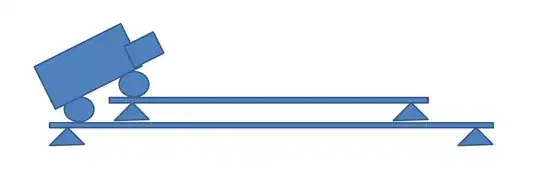

This simple trick greatly increases strength your construction can take: Put smaller planks on top such that they rest close to edges. Longer you have second set - better.
