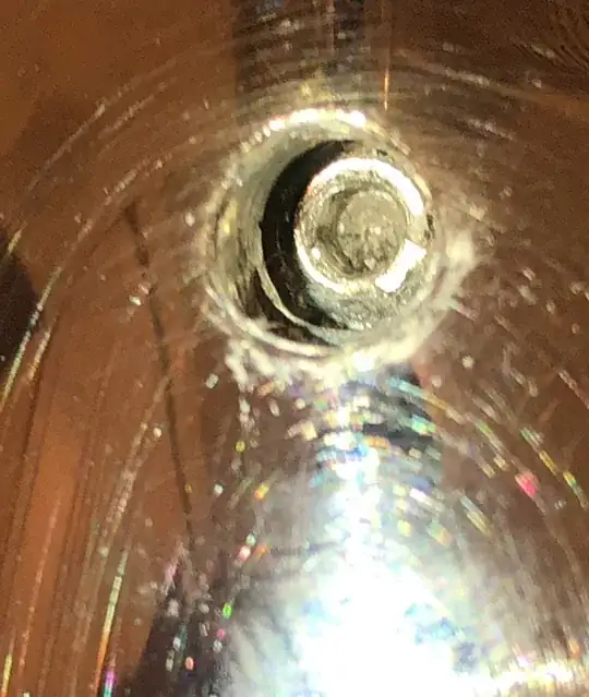

I am trying to unscrew the screw head you see in the picture. It is from the kitchen faucet handle.
From looking online, it is usually a hex screw head. I tried a hex-key wrench, it didn't work, and tried every tool I have that could fit with no luck.
I am clueless, which one to use. Appreciate any help. Thanks!
Faucet handle screw head
Lloyd
  • 121
33
It appears that the hex sides of that screw head have been rounded off due to the use of an ill-fitting hex wrench. A metric and an SAE hex wrench will both fit in there, but the use of the wrong one, while it feels like it fits properly, can be just loose enough that if the set screw is corroded in a bit, the wrench can slip and round over the edges.

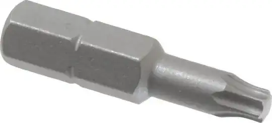

I mostly agree with FreeMan, but I think this was originally a Torx (six-pointed star) drive. The corners look deeper than I'd expect from an Allen drive.
I would get a set of Torx bits and look for the largest one that fits (which is the correct size for any screw head). Gently tap it in with a hammer, then attach the screwdriver or ratchet handle. While keeping the bit in line with the screw and pressed in tightly, see if you can turn it.
Once it's out, replace it.

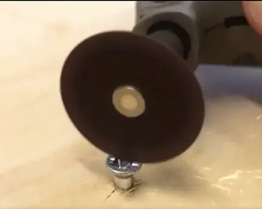

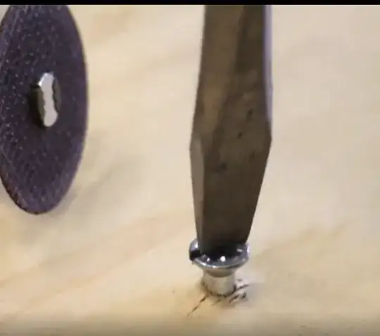

Giving a cheaper option, maybe you can try to cut a line with a rotary tool and simply use a flat screwdriver
Example GIF
