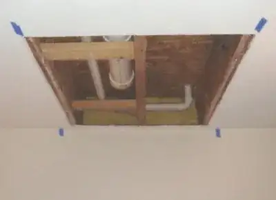

If you don't want to cover it with a medallion as the other answer suggests (a great answer, and popular practice in old houses) you will end up having to paint, so you might as well just fix the drywall properly. Cut a square around the fixture using a utility knife (scoring it repeatedly) or a drywall saw (being careful to avoid the wires).
Ideally you should cut it so you expose a half a joist on two sides, e.g. cut all the way back to the edges of the nearest joists on either side. This is a pretty good example, but you only need to open up one joist bay.
Then cut a piece of drywall the same size, and measure the location of your fixture, and cut that out precisely. Reinstall the square, tape, mud & sand.
While the ceiling is open, you could replace the box with something bigger to solve your other problem.
Drywall Repair
Picture from knoji.com which provides more detail on general drywall repair.
