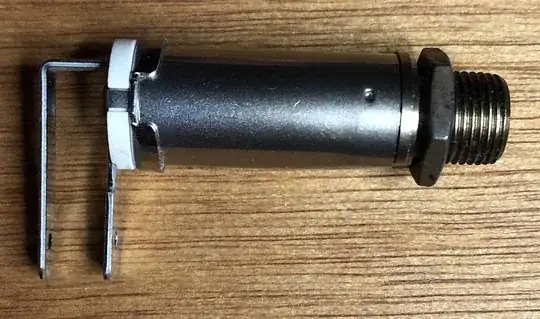

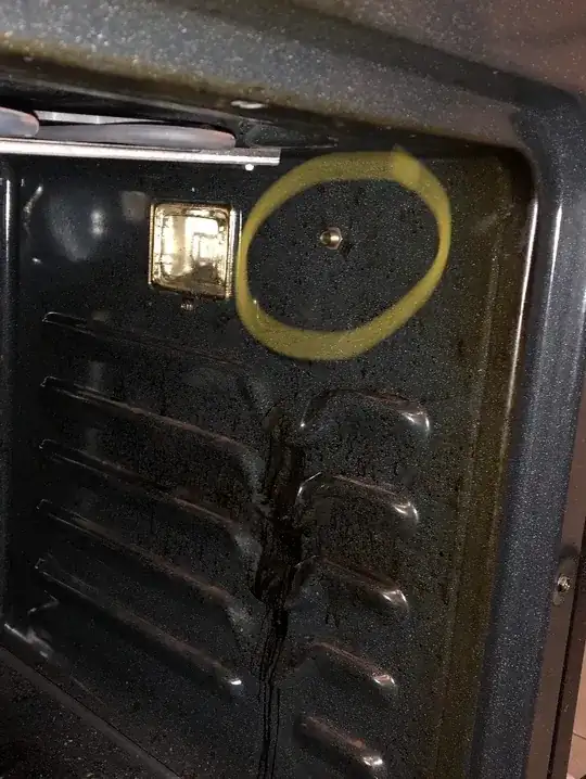

I am in the process of replacing the controller for a jenn-air oven. Ever curious as I am, I was poking around the wiring for all the sensors and elements, tracing them out, and learning their function. Then I came to this, and I have no idea what to make of it: image of a one-quarter inch headphone jack image showing the location of a headphone jack inside an oven
It is a 1/4" phone jack. INSIDE the oven. I am puzzled. Is there an option that uses this method to connect? Is some engineer at Jenn-Air trolling me? The connection on the controller PCB for this device is labeled "MT"... and the jack was (of course) empty. What is it for? Why is it there?

That type of connector is commonly used as a socket for a temperature probe that can be inserted into the food (usually meat) to measure its internal temperature instead of the air temperature in the oven.
I imagine the labeling “MT” you saw probably stands for “meat thermometer”.

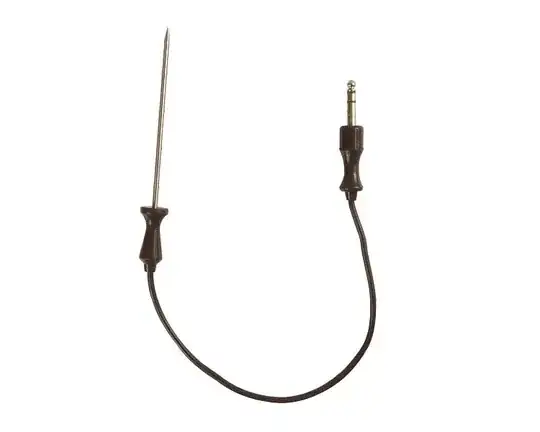

Temperature probe connection, indeed. Go look up the manual for your oven, or look around the junk drawer in your kitchen for the matching temperature probe.
Temperature probe image form genuinereplacementparts.com, no endorsement implied.
