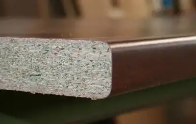

It's 38mm thick.
Next week I will need to cut it along a straight line, and I would like the cut to be as straight and clean as possible.
What tools do I need to do this ?

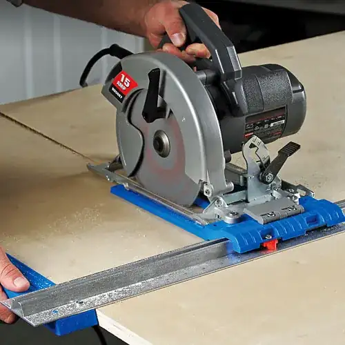

You can make straight cuts parallel to an existing edge by using a circular saw with a guide.
saw guide

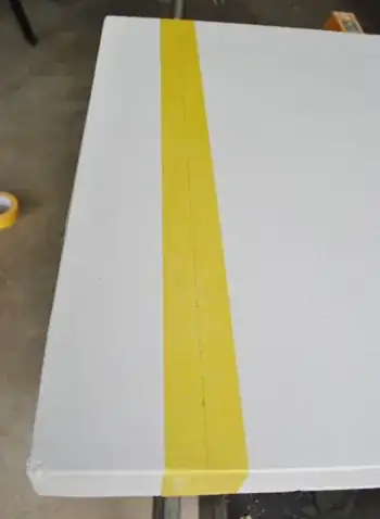

To make the bottom edge of the cut clean, be sure the saw does not cut much more deeply than the thickness of the material. You can also put tape on the cut line, before cutting, to prevent the saw from breaking off small pieces of the material on the top edge of the cut.
tape line

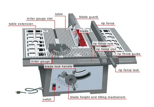

If you want to rip it (cut it on its long dimension), the only way to be sure it is straight is to use a table saw:
table saw diagram

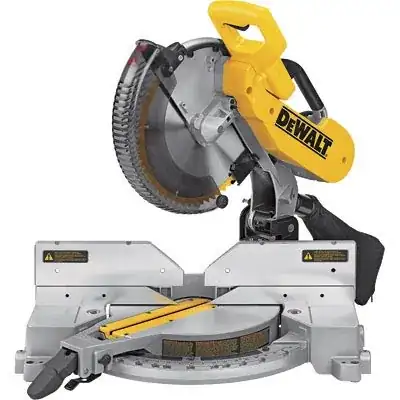

If you want to cross cut it (on its short dimension), you can do that with a miter saw if the piece is not too wide:
picture of miter saw

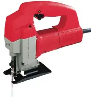

If you are confident in your abilities and it does not need to be exactly straight, you can make a line with a chalk line and use a jigsaw with an extremely fine blade (to avoid splintering the wood): picture of jigsaw
