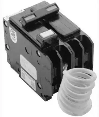

The exact breaker will vary by manufacturer. But it will be something like this:
Eaton GFTCB220
Sample image is from Amazon. Be careful where you buy your breakers (and similar items). If possible, buying "hands on, local" is preferred so you can make sure you get the right product (depends on your particular panel) and legitimate product (Amazon, depending on a number of factors, will sometimes substitute "equivalent" or used or other problem items, particularly if you don't know the details of how to order carefully.)
You don't need handle ties this way, because double breakers are, by definition, common shutoff.
