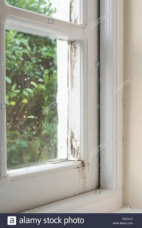

I have deep windows frames like this:
Rather that adding a whole secondary glazing frame on the inside. Could I add a spacer/battening to the inside of the existing frame and second pane of glass? I could hold the glass in place with either more battening or glaziers putty. So if the window has 3 seperate panes, I would do this for each.
