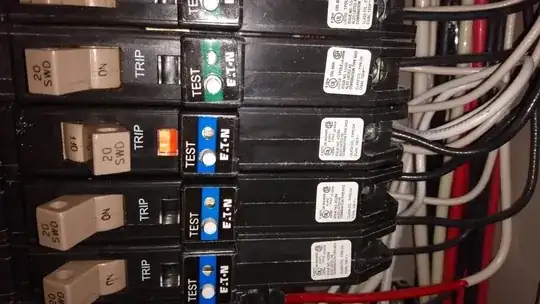

I have a house that is just under 2 years old. My 2 year old GE Profile fridge (model PWE23KSKJSS) is hooked up to a dedicated circuit that runs off a 20 AMP Arc Fault breaker. There is nothing else on this breaker, only the one fridge outlet and nothing else.
Everything was fine for 1 year, then my breaker tripped and could not be reset, as if there was a dead short - whether or not the fridge was plugged in. I tested for continuity without the fridge being plugged in and there was none, so it didn't seem like there was any kind of short.
I replaced the breaker with the identical model and it was fine for about 6 months, then the exact same thing happened.
So it really seems as if the fridge itself is responsible - as if the motor is burning out the circuitry in the breaker. Is such a thing possible and has anyone else had a similar experience?
I thought I'd post my question before replacing the breaker for a 3rd time, and I'm thinking just a normal breaker this time.
Eaton panel and Eaton 20 Amp arc fault breaker.

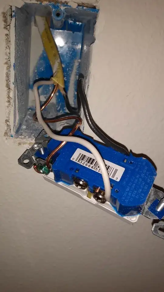

Try changing the outlet. A cheap fix if it works. Also try using that AFCI breaker in another similar load circuit and see if it trips as often as when in the refrigerator circuit.
-1
The wire connections on the outlet are not properly done. You have insulation under screw for the white wire and the black wire appears to wrap around the screw in the wrong direction. The ground wire could be wrapped a bit nicer as well.
