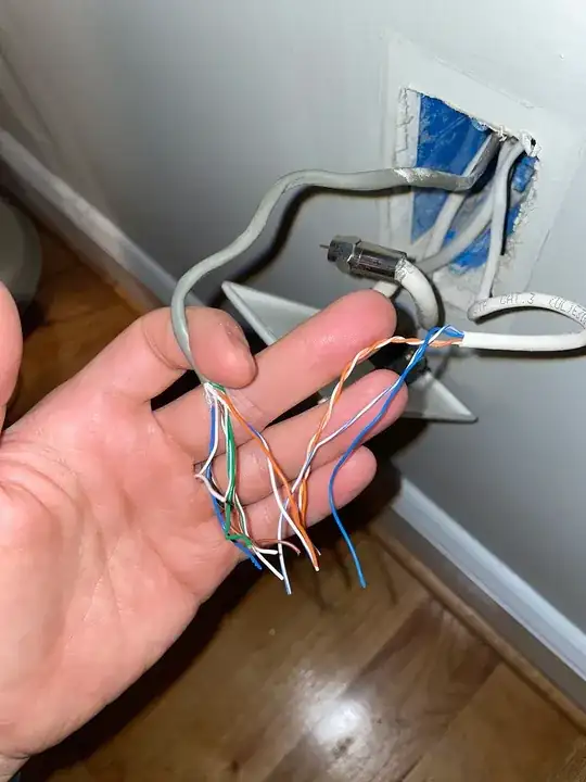

  • Living room: One 2-pair CAT3, one 4-pair CAT3, two coax (the previous homeowner had a router that was previously connected to one of these coax cables). Pictured, in case helpful: loose wires coming out of a wall

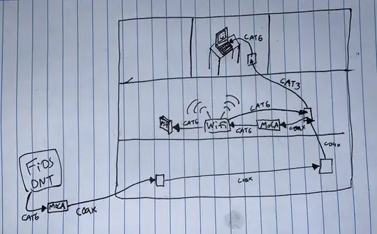

Migrating OP's solution/response from their question to an answer:
I took a little bit from column A, and a little bit from column B.
I got a cheap tone and probe kit to confirm that the coax and CAT3 daisy-chained through the whole house. And I'm using two MoCA bridges to convert the FiOS signal from Ethernet to coaxial, snaking through the house and converting back into a Wi-Fi router. Ethernet out from the router goes back into the wall, traveling upstairs via a short run of CAT3 in the wall. From my office upstairs, if I plug my computer into the wall jack, I get 100Mbps up/down with 7ms latency, which is exactly what I got from plugging my computer directly into the FiOS ONT.
I now get great speeds when plugged in, and feel good knowing that I'm taking advantage of the wiring in the house. (Most of it anyway—I am cutting the daisy chain short by one link.) Also, the Wi-Fi router is much more centrally positioned, so I get better wireless speeds too.
I am using MoCA, and also giving CAT3 a shot based on your recommendations. It seems to be working great so far.
Here's how everything's hooked up:
final house wiring diagram
